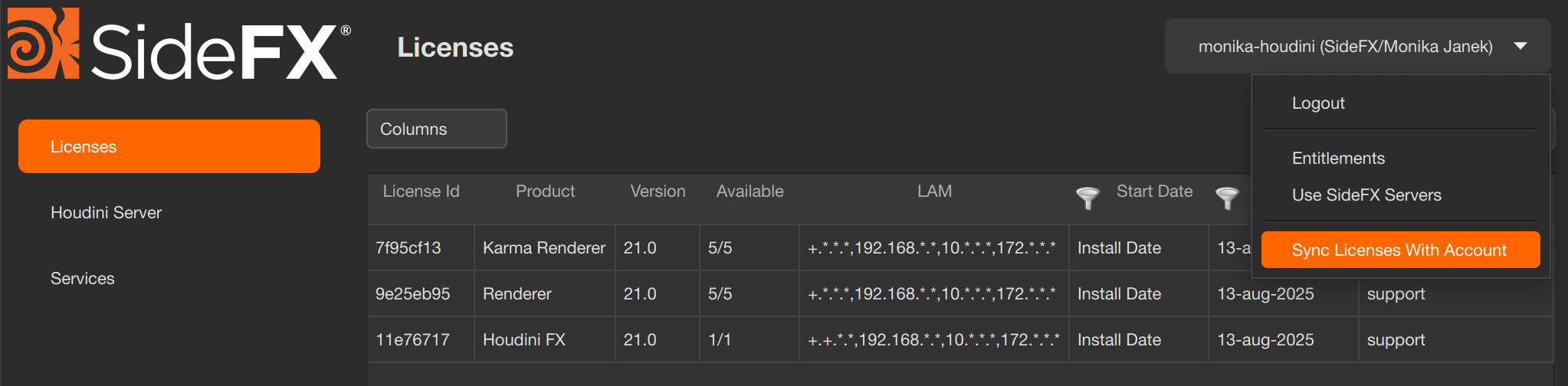

In recent versions of the License Administrator, you can select to synchronize the licenses to the machine.
General sync licenses
