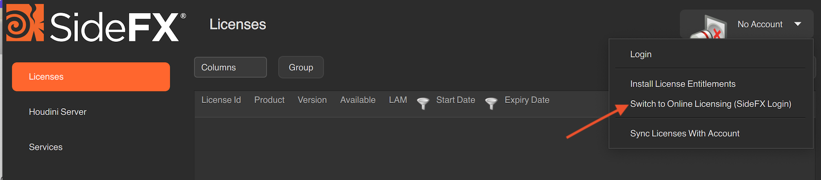

If you were originally using SideFX as the license server (login-based licensing), ensure that you are now not using your local machine.
Launch the License Administrator and navigate to the top right corner drop down menu, under the login option.
Select "Switch to Online Licensing (SideFX Login)". You may be prompted to log into your SideFX account if are not logged in.
SideFX Server
