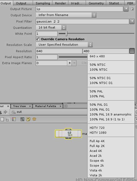

When I enable Override camera resolution in Mantra render node it's not possible to select any of given presets.
However it's possible to enter it by hand… so it's not a big bug
os x 10.5.6 (macbook pro, 2,4ghz, 4gb ram, nvidia 8600, 256mb)

I can confirm this as well with 10.0.272 on OS X. Interesting thing is I can select a preset once and subsequent tries with the mouse don't work. However, I can use the up & down arrow keys to highlight a preset & hit Enter to select it.
I'll submit a bug for this.
Cheers!
steven

This appears to be Mac specific and has been logged as bug 34673

This bug has been logged (ID=31917)
Side Effects Technical Support
