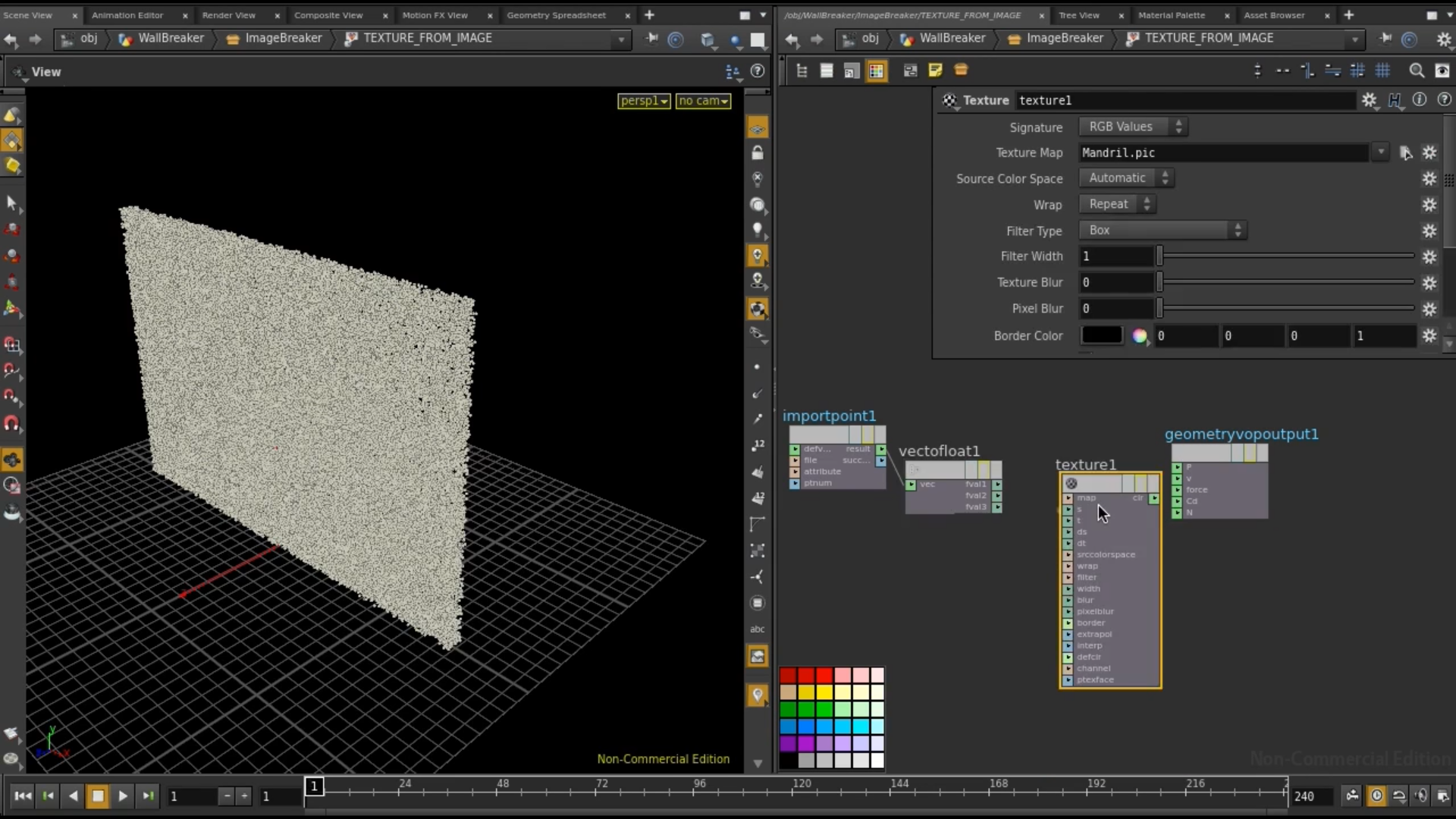

I have a question.As you see in these pictures points were cut by using Black and White Image. So, I want to do same by using wrangle. Can anyone type wrangle code to do that?

Joined: Nov. 2017
if(@textureData == 0)
removepoint(geoself(),@ptnum);
whereby @textureData is the texture value attribute
