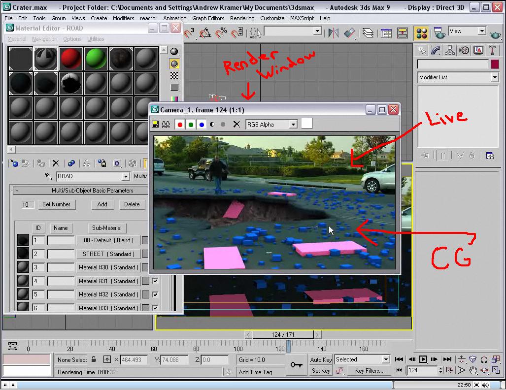

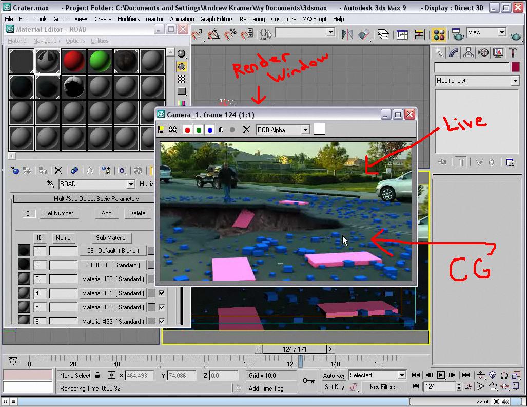

I would like to post another picture example of what im trying to explain. In 3ds max, you can load up an already tracked video and then put your geometry in with it and run test renders to get a good idea of what your final product will look like…it displays both the video footage AND the geometry in the render. This is what im trying to acheive in houdini so that I can match up the lighting and texturing. Is it possible to do this like max? If not, how can I acheive this? Thank you.

Add a grid to the scene that is the same size as the footage, and add the footage as a texture map. And no the camera doesnt need to be exported into a comp suite. You can do so, as compositors have a 3d side to them which is very good for faking things like parallax, but there really isnt any need to import the cam and tracks into comp. Unless you are wanting to anchor something to the footage in comp, but most comp suites have a built in tracker anyways.

Yes im wanting my 3d object to be anchored to the actual footage so that it doesnt slip. I wanted to use boujou instead of having to use the built in compositors tracker. I wasnt sure how to do that.
