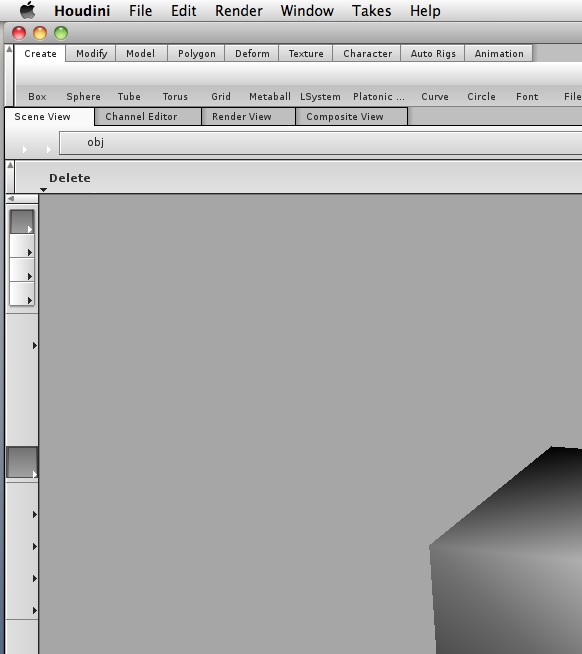

I'm on 10.0.397 with the 2007 17in mac w/ 8600m video card. I'm still getting flickering in the viewport.
Good new tho, my menus are back!

Hi all Mac OS X users,
I have a iMac 2.4 Ghz with a ATI RadeonHD2600 256 MB. I never test Houdini on Leopard. I install the version 10.0.401 fix the permission on the 2 folders. After that I can launch Houdini. Unfortunately, I don't have any icon and the interface is very very slow… 2-5 second lag on any process.
That issue is due by Snow Leopard or my iMac is too old ?

Since you are on ATI, it's not likely a display driver problem. Make sure that you have X11 installed on your machine. It's an optional install on OS X. The program that we use to convert out SVG icons has a dependency on X11.
If you don't have it installed, you should be able to install it from your OS X install DVD.

So after install X11, Houdini works well ! Icon is present and no openGL lag !
