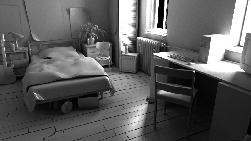

thx Jason, i did some tests on Friday, it definitely seems to help lowering Ray samples and increasing Pixel samples and just not really messing with the Noise Limit. thx for the info!
yes i'm using gamma 2.2, my environment is also a large room, but very dark, only the area around the character is illuminated.
i'm finding it's easier to get smoother renders with more “ambient” scenes, dark contrasty seems to be a bit more tricky, especially with glossy surfaces.

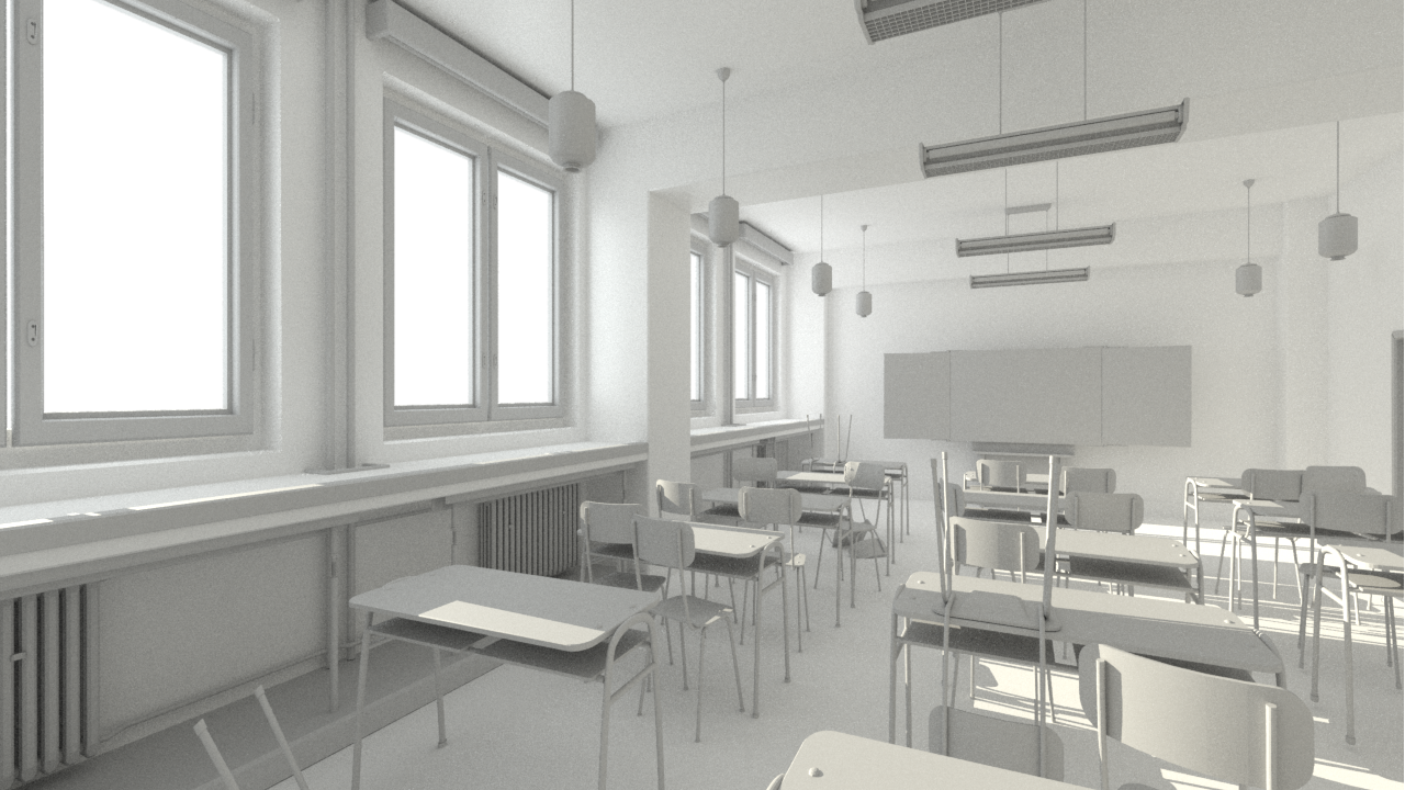

I see you've already set your Diffuse and Reflection Limits way down – but I see your sampling settings aren't really ideal.
So: the I've found the relying noise variance algorithm to provide you clean illumination is not ideal. We've just done 200 shots using PBR and these are the sampling settings that worked best for us:
- Pixel Samples: 7x7 (up to 10x10 if the scene really needed it)
- Min/Max Ray Samples: 1/9 – sometimes 2/9
- Noise Level: 0.08 (this seemed good enough to us … less than film grain)
- Reflect/Diffuse Limits: 2, 2
- Color Space: Gamma 2.2
- Color Limit: 4 (your 1 is clamping way too hard)
- Photons: 2m photons for a huge room. Yours is 7m! I'm sure 1m is fine for this space. Ratio was 2.5.
Be very careful of displacement. The default Mantra Surface shader is less efficient than a Plastic shader because of mere presence of the displacement shader. Our shader manages this with the “Disable Displace Shader Rendering” property but the distributed Mantra Surface-based shaders don't.

Holy Jason!!! those settings rock mate, very nice clean image, I've been fighting noise for a while with no nice results, but this recipe rocks mate
thanks for that
