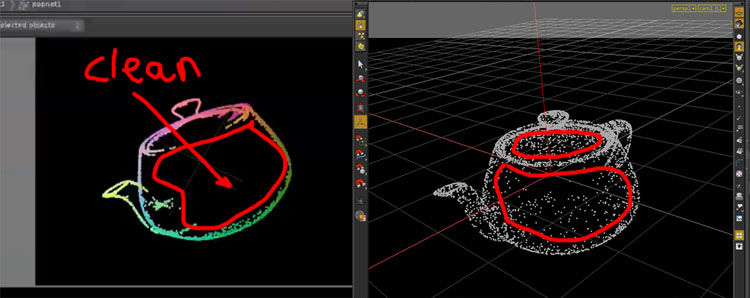

Good morning,
was reading up on this page and tried to replicate his scene.
http://adamswaab.wordpress.com/2010/02/23/houdini-particle-aura/ [adamswaab.wordpress.com]
Not being a vop expert, i tried to get as far as i could. I attempted to source particles using the ‘emit attribute’ calculated within the vopsop.
Frankly don't have a solid understanding about the calculation happening within it. Would be awesome if someone share some insight!

and what seems to be the problem?
set Initial Velocity on Source POP to Inherit Velocity and put like 0.01 in there
seems to emit correctly from camera relative edges
is it not what you wanted?

Maybe i am understanding his set up wrongly. In the video he was able to source particles from the profile of the teapot… While my example file still had lots of stray particles on the body of the teapot, i suspect our numeric values inside the vopsop are different.
Plus his particles only emits off the teapot's profile which is visible to the camera, do i have to perform some sort of backface culling?
Hope i dont sound confusing…

you can just tweak the ramp curve on the VOP SOP to isolate the region you want the particle to appear in
right now it is linear falloff from perpendicular to parallel so you will have some points across the whole surface
normal_perpendicular_to_cam_vopsop_fix.hipnc (126.2 KB)

Yayyy tamte, that's it! /thumbs up
