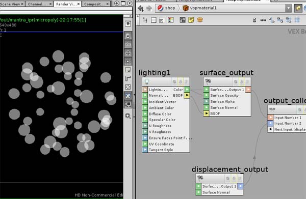

Hi Jpparkeramnh:
Thank you for your advice! Sorry that I don't know much about Lighting Model. The way I have is to first create a VopMaterial in SHOP, then create a light model and connect it to Surface output (as the image below). However the result is looking weird… may I ask for more information on the settings of materials please?
Thank you for your time

You should modify opacity with another VOP, like a constant or noise.
Generally points don't look good large and up close, and the answer is usually to generate many many more of them so that the individual points are no larger than a few pixels on-screen. This way they all average together to create a more complicated look. The sum is greater than its parts, as they say.
