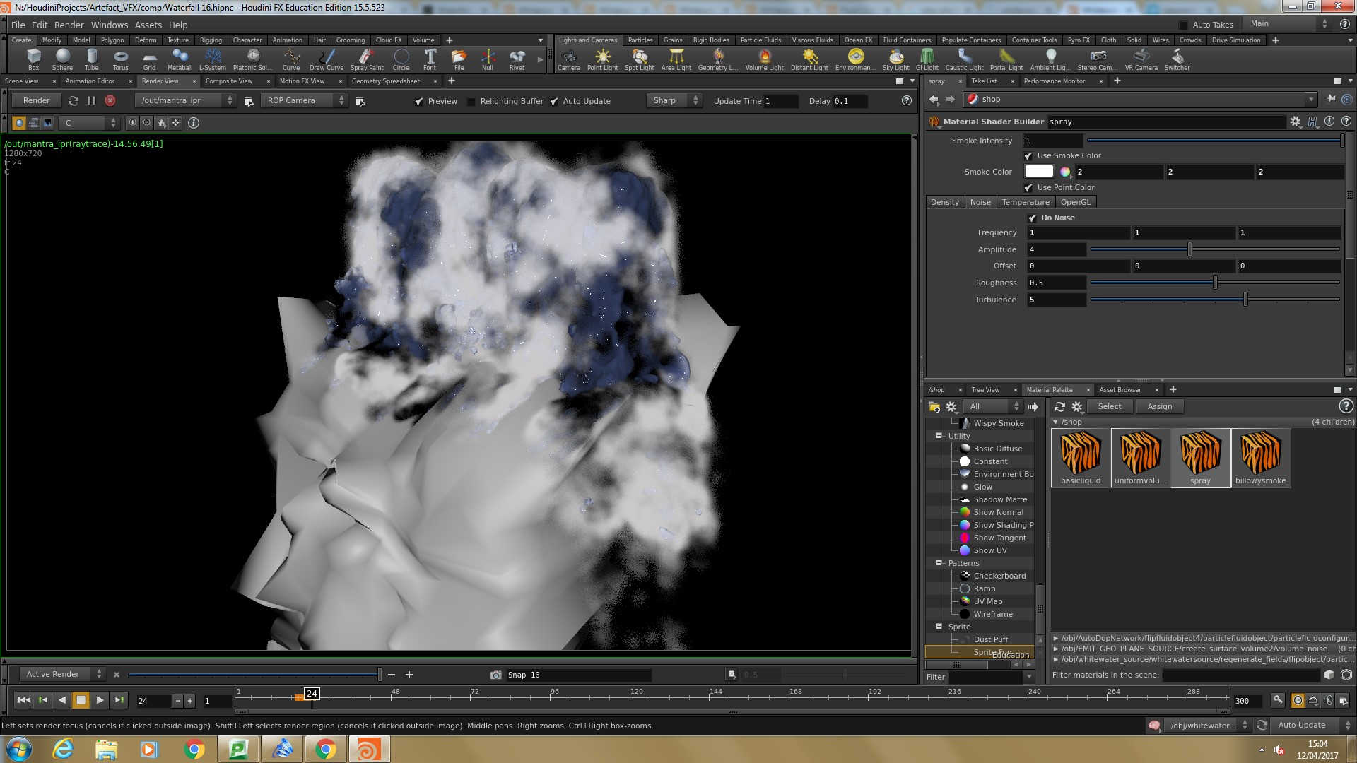

That's said, my question is, please, how can i get a decent whitewater foam look?
By default, the material applied is the default spray shader but gives me that smoke look. (joined screenshot) and even reducing voxel size doesn't help me.
The documentation looks poor about that but maybe it's so obvious that it doesn't need more explanation?

I found it! By changing the shader to billowy smoke, reducing the voxel size, and the last secret information that i couldn't find anywere, is to reduce pointwrangle= @pscale and tweak from there.
Now i'll need to find how to render only the top of the flip simulation. I'm hugely open for informations guyz!
