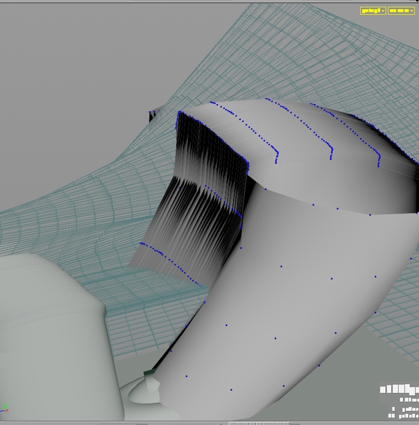

yes, reproduced it, here is the crash log, and a screenshot, which is another thing i get frequently, especially when using right click menu.
Just to note, the crash happens with a larger scene, with basic primitives i was unable to reproduce.
win7 64 bit
geforce gtx 770 (4gig ram)
driver: 327.23
i tried newer drivers, but had a scene where i was manipulating 500k objects as packed, and when i switched to newer drivers, the thumbling of the viewport slowed down 3 times, so i switched back to this.
