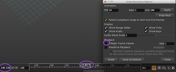

Gyroscope
Testing it further, it might be a bug, but those buttons don't become active until you move a handle. If you just single click on the bezier line or end on one side, the buttons are still inactive. You can still hit T however.
It's be worth reporting the bug to SideFX, use the Support menu above. I can't reproduce it here on OsX H13.0.359. Always test with the latest daily build too.
The best way to report bugs is to use a screen capture recording if you can.
Thanks!

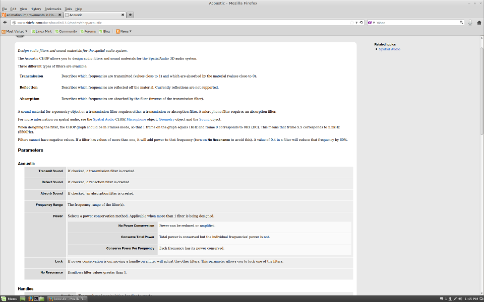

i better show you in images then try to explain. We have the document(in this sample Channels nodes - nodes 001) and then next pages start to show up each node in detail(in this sample only the first node Acoustic - subpage) in a flowing succession. It results a pdf document with categories like now BUT, the full documentation comes AFTER the nodes, not on separate links like now. so we have:
chapter 1 - Channels. first page lists channel nodes, then next pages each node in succession within the same chapter, not on separate pages/links. right now you have the list of nodes, then you need to go ahead and open a page at a time and make it a printable document, return to nodes page, click on next one and so on…. for reading about a node online maybe it's ok, for printing full documentation and learning all nodes from zero on each context not at all. maybe i am an old fossil and try to print a manual to learn from it. This time maybe i explained a bit better.

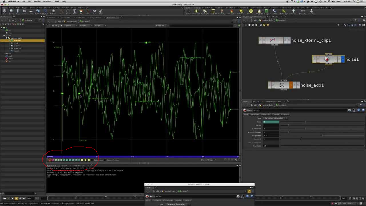

Constantin X
Now how about those nasty little icons(see the image attached)?
They look marginally better in the Light scheme, but I think they're still the old-school vector icons Houdini used to have. The coloring is meant to divide up the operations into groups, and that'd be better handled by grouping the buttons and removing the BG colors, I think. I'll put in a request to get those updated, as it's likely they slipped through the cracks when the icons were redone in H9.
