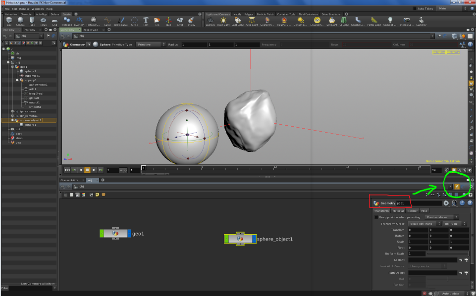

@ConstantinX: You network view is locked, that's why it does not change
99 posts
Joined: July 2007
sanostol
What he said
