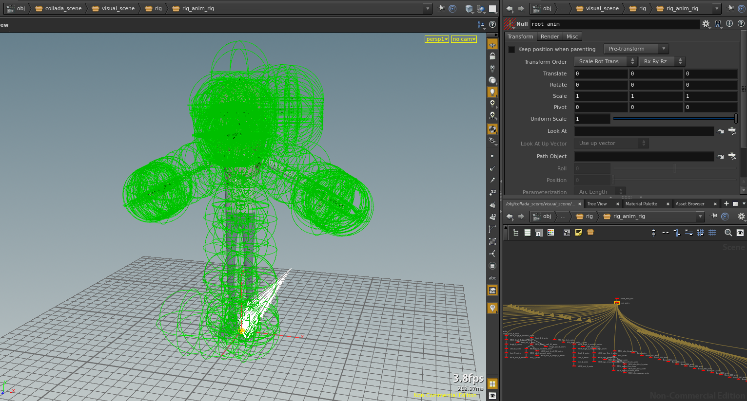

Take a look at the images and you'll see what I am experiencing with importing a FBX from Blender.
Screen Shot 2015-07-31 at 10.58.33 AM.png (495.1 KB)
Screen Shot 2015-07-31 at 10.56.50 AM.png (81.1 KB)
Screen Shot 2015-07-31 at 10.51.45 aM.png (60.3 KB)

Collada is a little better, but still imports into Houdini completely broken.
Screen Shot 2015-07-31 at 11.05.33 AM.png (674.6 KB)
mjedewaard_cartoonguy_v1_0.dae.zip (2.4 MB)

2447 posts
Joined: June 2008
from FBX you should be able to get bones with animation and skinning,
This is exactly what I thought as well. I should be able to get a skinned working rig but that is not my experience.
