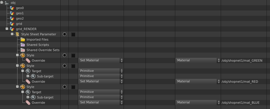

Then I assigned a simple Style Sheet set on the object. (with_style_sheet.png attached)

STYLE SHEET ENABLED (see style.png attached)

One way you could speed up this particular file is to get rid of the sub-target, and instead set a condition on the top level target, using a Primitive Group of @path=*geo0*, and @path=*geo1*. There is still a big slowdown, but not as much because mantra doesn't need to evaluate the style sheets for the primitives inside the packed primitives (the material gets assigned to the packed prims themselves).
The basic problem is that style sheets can do just about anything to the materials in your scene. Each primitive inside each instance could in theory have a different material assigned by the style sheet. In such a context, the increased render time and memory usage would be understandable. Unfortunately right now mantra is not as smart as it could be about short circuiting some of these evaluations when the style sheet is not going to set overrides at that level of granularity. This results in excessive unpacking/unsharing of geometry and evaluation of style sheets, which leads to the slowdowns you are seeing.
In my original setup (the one where I experienced the issue initially : from 5 min a frame to 8+ hours a frame 20% of the frames, and memory crash for the remaining 80%), I initially created a very simple Style, containing just a “set material” to the whole Object.
Anyway, I removed all the conditions and sub-targets in the example hip file too, and I definitely got some improvement.
Frame 100 : 3' 55” (opposed to 6' 20” in the version with target Conditions).
