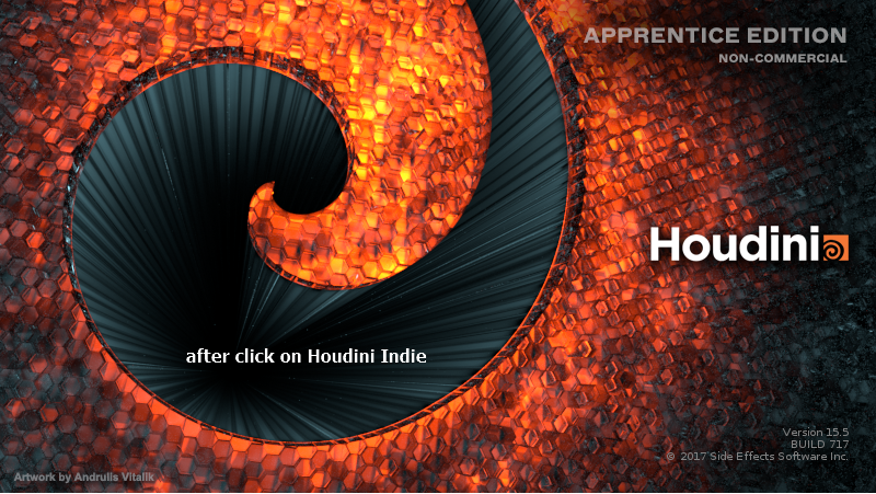

But the result after i follow every step is when I try to open Houdini Indie version Its kept bringing me back to
houdini apprentice
Once I click the shortcuts icon it keep open houdini apprentice.

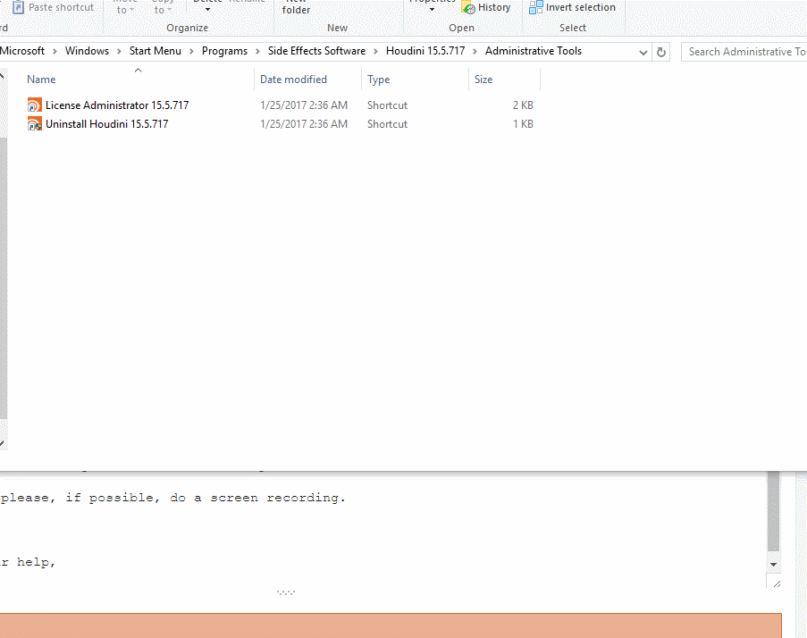

Thank you so much for your help,
I follow step you guide also record gif image, still houdini apprentice version , did I miss any steps ?

Hi, your license manager should have Houdini Indie listed. (yours only has Houdini Engine Indie)
I'd suggest you try the following.
1. Check that you bought a Houdini Indie license, not a Houdini Engine license. - Not sure this is actually the issue as Houdini Engine Indie comes free with Houdini Indie. It looks like you have 3 Indie Engine licenses and no Indie.
2. Check that you installed Indie correctly. - When installing, you have some options for the license manager. Currently it looks like you have Engine installed but not Indie itself so a clean installation is a good option.
3. Go to the Houdini/bin folder and run hindie.exe instead of using the shortcut (or check that your shortcut is pointing to hindie.exe) - I know that running hmaster.exe or houdinifx.exe will launch Apprentice if you don't have the license so I expect hindie.exe does the same.
Rob
