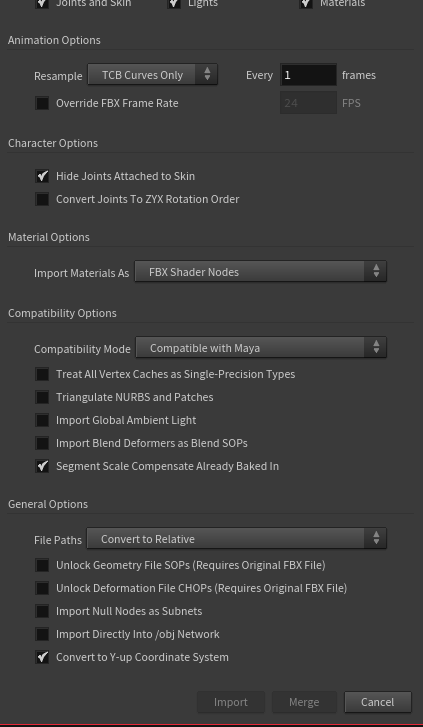

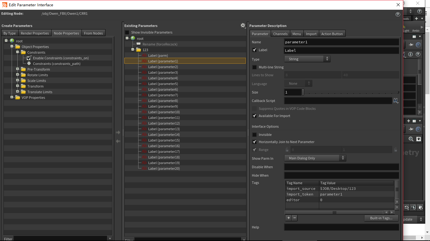

When editing parameter interface(houdini 16),if I click on one of the string parameters,
the “Apply”,“Accept” buttons jump out of the screen!
to get them back,I have to rotate my screen 90 degrees,which is very annoying.
My screen resolution:1366*768
there are same issues when I try to importing FBX (houdini 16&15).this time the path channel jumps out of the screen.however,it's ez to solve this just by draging my windows Os taskbar to the right side.
Nightmare!poor UI behaviour

Moin,
while one could claim that the resolution your monitor allows you is not exactly “up to date” (with 4k slowly becoming the new standard that replaces the de facto FullHD standard), you can easily make your options windows smaller (see attachment). If you cannot reach the bottom border to shrink the window, press ALT+Space (on Windows) to bring up the window menu, then select “move” and move the options window down a tad, so that you can grab the top border and shrink the window vertically.
Another option is to use the environment variable HOUDINI_UISCALE and set that to something smaller than 100 (the value is given in percent), that should, probably, shrink your UI elements, but might make them hard to decipher.
