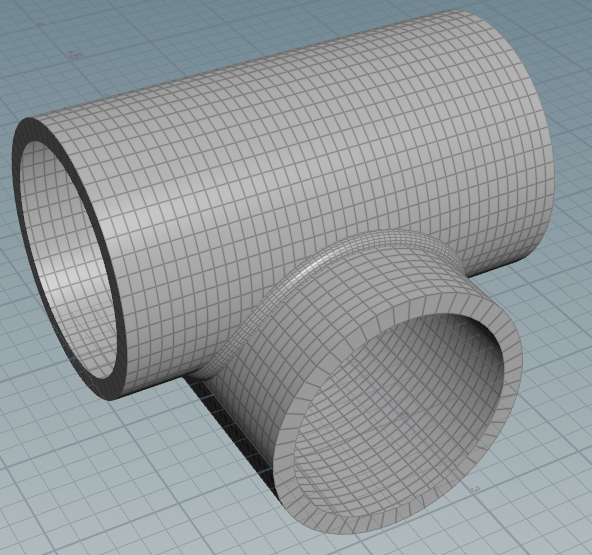

This is not even a Houdini limitation, no tool out there bevels beyond the immediate ring of polygons. Doing that would easily as difficult of the boolean if not harder.
That's correct. XSI doesn't do this either, but it does not cap the width value the user can input like Houdini does. The geometry, as seen below in the 1st image, is a mess and you wouldn't want to use it like that anyway, but in some cases, it's good to have the option to go crazy.
Whether the bevel tool should check beyond the first poly loop or not is something I haven't thought much about, although after a brief mental gear screech, one would probably need to clean the mesh anyway if it's for a model and not for a simulated mesh which can be triangulated w/o problems.
Vux's tool produces a nice result, but in some cases where the topology is crucial (quads or quads&tris only), it's not very useful as it is.
The best way to tackle this Sub-D modeling problem is like in the attached .hip file.
If there was a “clean orphan points” (points with only two adjacent edges) option on those Boolean ops, the result would be much cleaner - now one has to roll up his sleeves and manually clean those edges.
p.s. the mesh in the .hip file is messed up for some reason - I must've changed the polybridge group or something and saved after I took the print-screen, but the idea is there.

For bardia's interest foremost (will also submit a RFE if necessary).
I'll explain a bit what I meant earlier with excluding points from B only when doing a Boolean A-B. More precisely, “preferring” to purge from B not “only”, because in some areas points from B have to be preserved. I'll try to explain as best as I can, with images too.
The 1st image shows a very low “edge length threshold” (ELT), of about .0001. Points market with red are the ones that should be purged, since they belong to object B.
The 2nd image shows the resulting geo after increasing ELT a bit - .009. What you'll notice is that the geometry has been cleaned up but the purged points are not the preferred ones (from a topology/modeling standpoint), they belong to either A or B (the algorithm probably looks at edge length only and disregards the points' provenience) and this is not desirable. The marked purple edges that have been created after the “wrong purging”, are taking the topology into a less than optimal direction. Marked with a faint green are the edges that should've been preserved from the spared A's points.
Will be watching this thread in case there are questions or I've messed up something.
