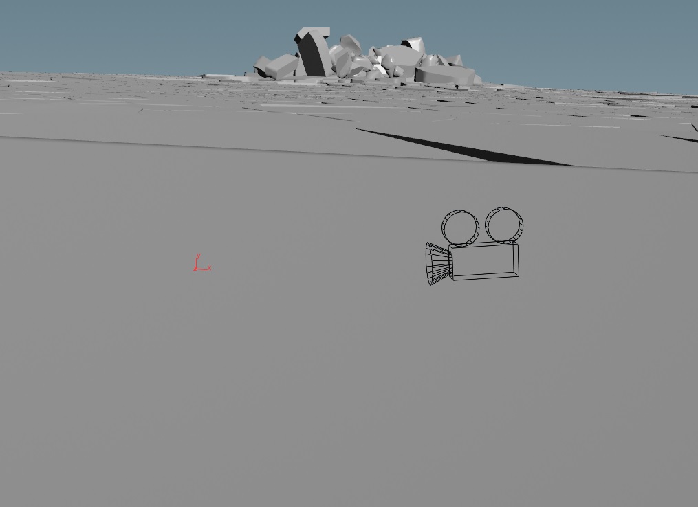

Anybody? Just want to add the rotation of my initial alembic from Maya to my fire pre-calculated in Houdini. Or another way to parenting this two elements..
I take this opportunity to ask another question: in my scene my groundplane catch some light of my fire. How can I keep just the light without the geometry of the ground? Light disappear with a matte_shading or shadow catcher..
I attach pictures for my two problems
Thanks !
