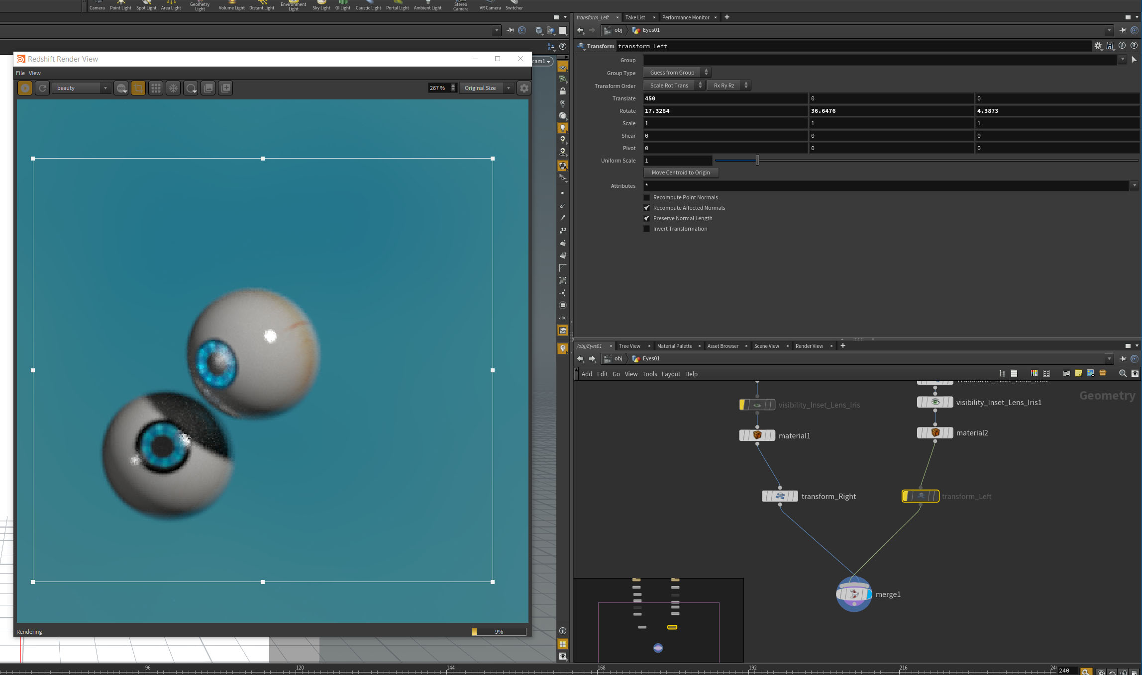

I can't for the life of me figure out what is going on here
When no transform there is no transform SOP the texture placement on the iris geometry seems ok, but when I add a transform, it moves

Looks like it is something else.
Maybe just check your render settings. Change the Raytracing Bias from 0.001 to 0.0001

Oh, I am rendering with Redshift
So unless it is a redshift setting, but I don't think so
323 posts
Joined: Jan. 2015
could have to do with this:
rest position
http://www.sidefx.com/docs/houdini/nodes/vop/restpos [www.sidefx.com]
http://www.sidefx.com/docs/houdini/nodes/sop/rest [www.sidefx.com]
