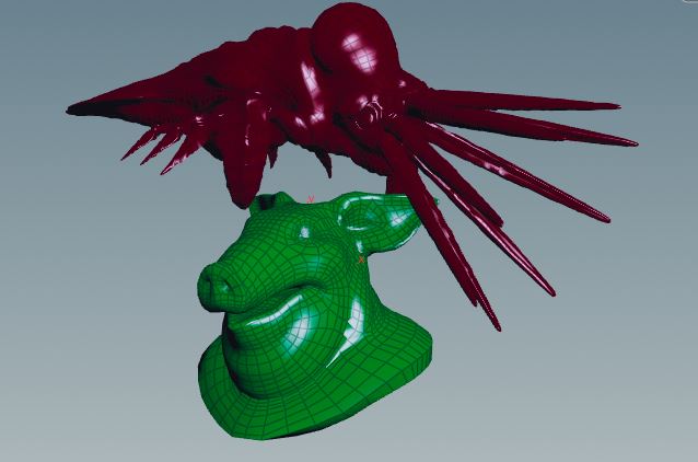

Yes, this works… but now I face a different situation where this approach does not work. I'm trying to pointdeform piece by piece while I have overlapping pieces :
This is the hi res mesh…
Whose name attribute match the lo res animation…
But if I simply do a pointdeform of the whole thing…
I'll get some stretching because of the overlapping pieces at their rest state…
So I need to use a for each loop to pointdeform the mesh piece by piece…
And that gives me a proper deformation…
But I'm not sure the group/merge/blast workflow is the optimal way of doing this. I feel like I'm taking up a lot of extra memory when all I need is to reference to the matching piece of the second geometry inside the loop. This is a simple example with just 2 meshes, but I have hundreds, maybe even thousands of pieces to process in my set-up and I'm trying to figure out the most optimal way of doing something like this.
