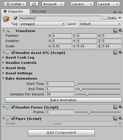

If anyone can help me - please!
1) getting an error:
InvalidOperationException: This cannot be used during play mode.
UnityEditor.SceneManagement.EditorSceneManager.MarkSceneDirty (Scene scene) (at Cbuildslave/unity/build/artifacts/generated/common/editor/EditorSceneManagerBindings.gen.cs:202)
HoudiniAsset.build (Boolean reload_asset, Boolean unload_asset_first, Boolean serialization_recovery_only, Boolean force_reconnect, Boolean is_duplication, Boolean cook_downstream_assets, Boolean use_delay_for_progress_bar) (at Assets/Houdini/Scripts/HoudiniAsset.cs:1270)
HoudiniAssetOTL.build (Boolean reload_asset, Boolean unload_asset_first, Boolean serialization_recovery_only, Boolean force_reconnect, Boolean is_duplication, Boolean cook_downstream_assets, Boolean use_delay_for_progress_bar) (at Assets/Houdini/Scripts/HoudiniAssetOTL.cs:145)
HoudiniAsset.OnEnable () (at Assets/Houdini/Scripts/HoudiniAsset.cs:759)
2) How can I change the parameter with my script?
Detlef
