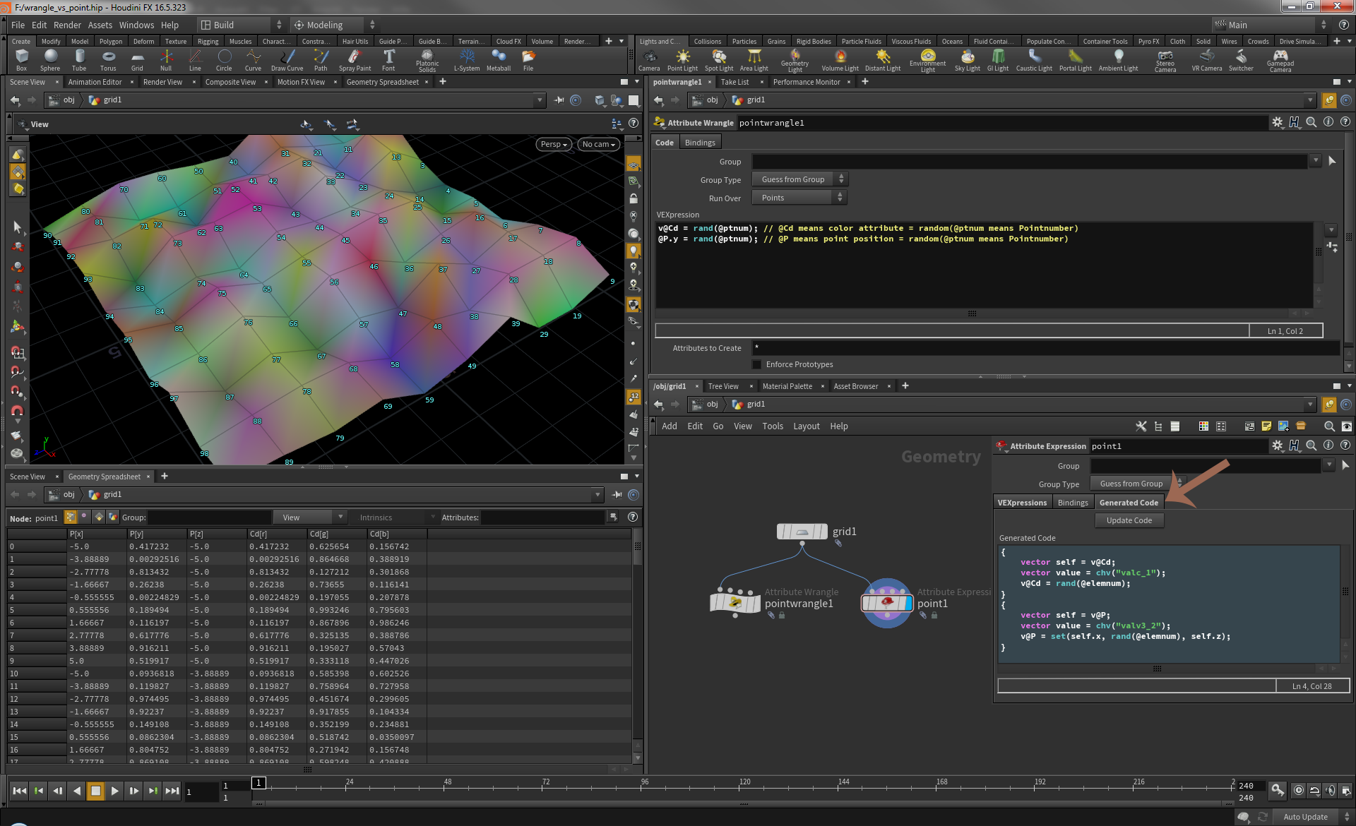

What do you need at all, maybe you are looking for wrangle
not the point node?
To answer your question, please see picture
notice that you can get same result sometimes “easier” with a wrangle.
Have always a look at the spreadsheet, too.
not the point node?
