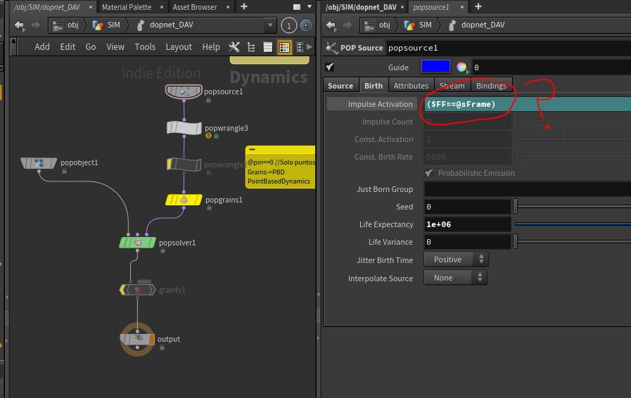

Hello everyone, I need some help here.
As you can see in the picture, one line started at frame 40 (@sFrame=40) and the other one started af frame 42 (@sFrame=42).
I want to pass them inside the dopnet exactly at that frame, so I use one expression on “Impulse Activation”: something like $$FF=@sFrame. I tried many combination but could not make it work.
Can somebody help with that?
Thanks in advance.

Trying to explain it better:
1st line is generated af frame 40
2nd line is generated at frame 42
I want to introduce them into the POPsource at each corresponfing frame: 40 and 42.
I was trying some expression that gives a True 1 result on frame 40 and 42. (Something like $$FF=@sFrame)
BUT it seems that the dopnet only read the attributes an the first frame. So I was trying to get the attribute value @sFrame outside of the DOPNetwork with some expression like this: ($F==point(“/obj/SIM/OUT_dynamicCurves_DAV/, ”sFrame", 0))
Can somebody help me to understand how could I do it?
How can I introduce into the DOPNetwork two geos that are born at different frames?
Thanks.
Thanks.
