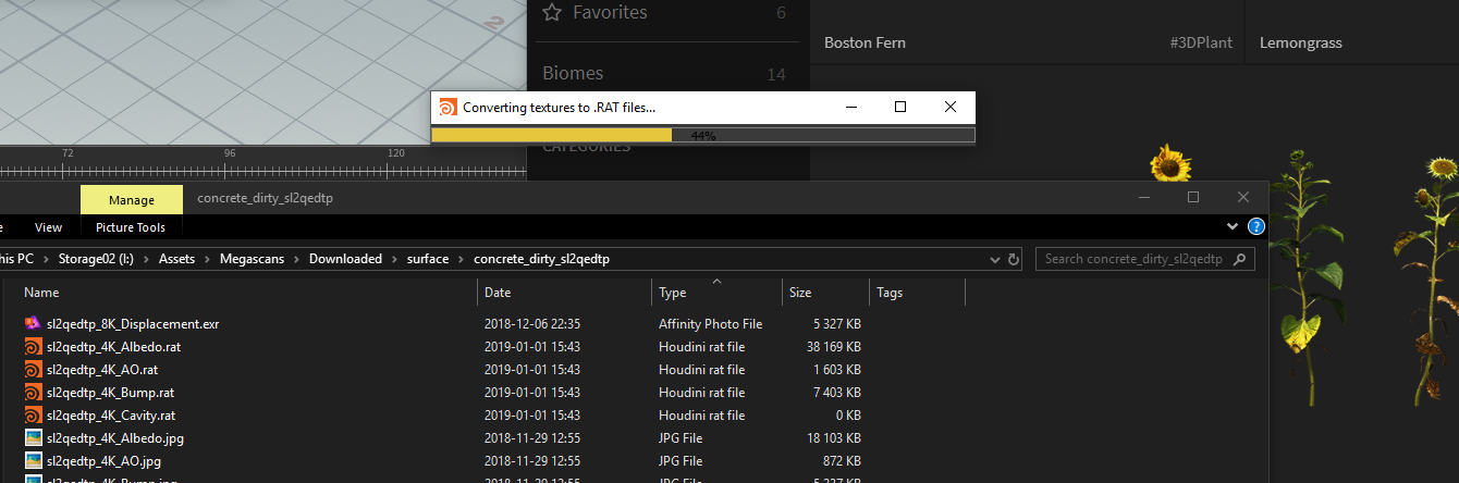

Also, we'd want to convert to RAT format not EXR, so I was hoping to add that myself after extracting the Appimage. I'd definitely recommend you add that too, as EXRs are much slower and use a lot more memory in Mantra than RAT.

@pbowmar:
- something coming for you in future updates, see attached images.

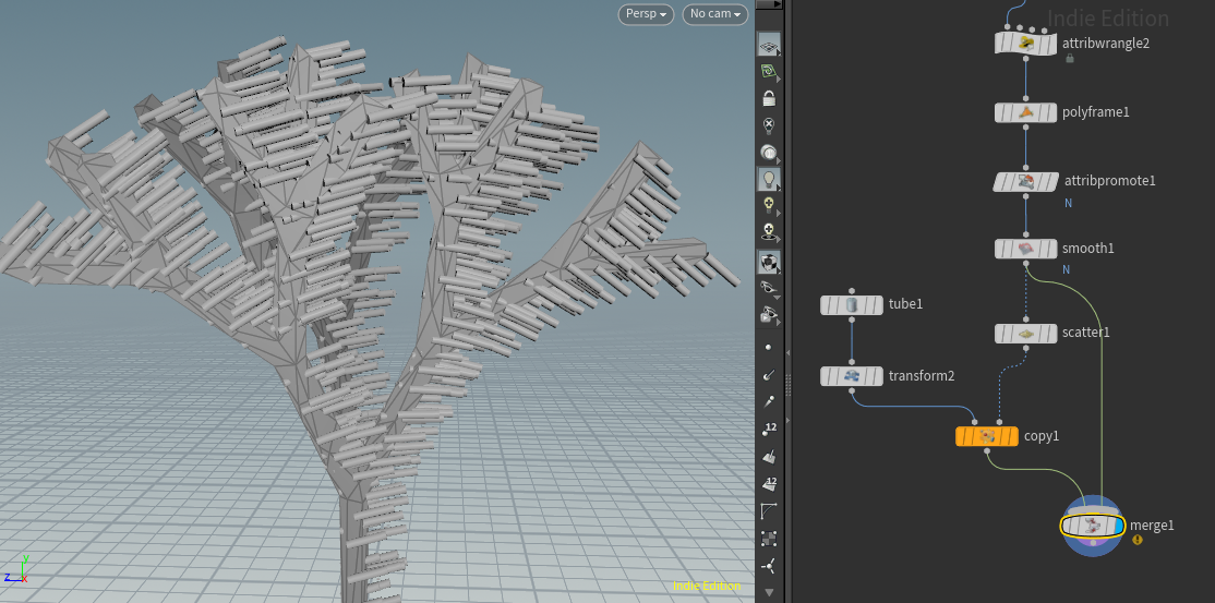

hello Magnus, thanks for your help and support, I just tested on copy stamp, the tube goes in the same direction, maybe it needed too the up vector ? I will test directly on a quixel scatter soon.
see the 2nd image test with quixel scatter.

@efxlab, It looks like you skipped the step preparing the twigs mentioned in the video, and then skipped the step customizing the quixel scatter node. The example file was only meant to help with how I calculated the growth direction. You still need to do those other steps in the video.

Yeah Magnus I got it for preparing the twig, it was clear, but for the quixel customizing it was not very clear. Is it possible to show the node you modified and where is it in the graph ?
