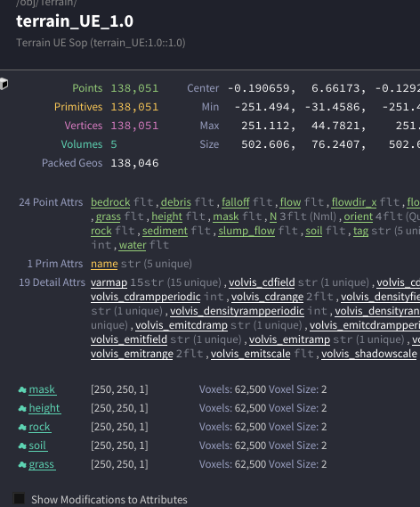

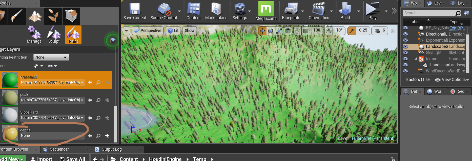

But when I import HDA and build instance, I found that the debris layer does not have an automatic layer info like the rest three
As you can see, in image 1 the debris layer can be visualized, so Houdini knows the debris layer has info
But in image 2, the unreal terrain info layers shows there is no debris layer info
