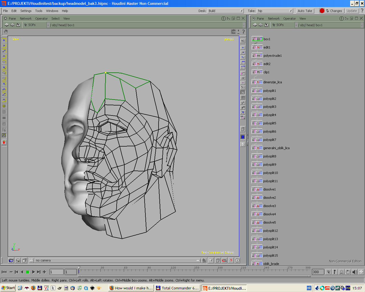

incidentally, ive attached an image of a good way to work in subD in houdini just for interest..
template output is set to smooth shaded and current operator is set to wireframe. add a null and your subd at the end of the chain and work upstream from this. then you can assign the subd node to a group where you can easily toggle teh template flag on and off, regardless of where in teh chain you are working.
admitteldy it will only show you the output at the very end of the chain, but isnt this what you usually want? its what you get from the other pakages as youre always working at the end of your chain. dynamic subd on any operator would i guess be cool, but imo a little unnecessary as its so easy to do what you want anyway.
