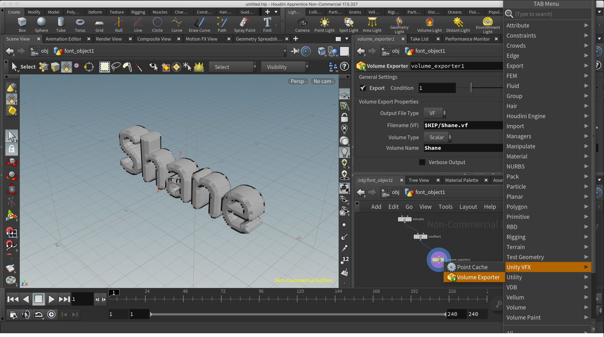

From what I have been reading the export tool should be a SOP node. But looking at the available export nodes after importing the tools, all I see is in the below image.
Am I doing something completely wrong or are these tools only allowed to be imported in paid versions of Houdini?

Hey,
The tool/plugin is available in this .hda file: https://github.com/Unity-Technologies/VFXToolbox/tree/master/DCC-Tools~/Houdini [github.com]
I just made some progress on this. I have created the .vf file, now trying to use it in Unity.

To save VF file you must use
1. isooffset node
- set OutputType to : SDFVolume
- set Name : vel
- set Uniform Sampling Divs to : 64
2. connect your geometry node to isooffset node
3. connect isooffset node to volumeexporter node (from Unity plugin imported to Houdini)
4. in volumeexporter set
- OutputFileTyle : VF
- VolumeType : Scalar
- Volume name : ver
- check box Export
this save SDF to VF file …
