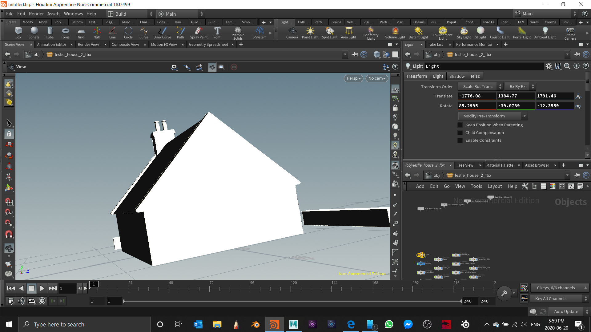

Hi, I'm totally new to Houdini. Been working in Blender for a bit. I think I have a similar issue (if I'm understanding this correctly). When I move an object (alt+left click) ie horizontally; to view another side of the house, by the time I get to another angle, the view is all wonky. I can't seem to keep it straight. I don't have that issue is Blender or in my Maya attempts. I don't know if I am supposed to adjust settings??
I've attached images, hopefully it works.

686 posts
Hi plabill, this is most likely down to the 3D Viewport preferences. If you change from ‘Standard Houdini Tumbling’ to ‘90’s Style Euler Tumbling' it should behave similar to what you're used to.
DaJuice
@dajuice
you saved my life. that was it. thank you thank you thank you
