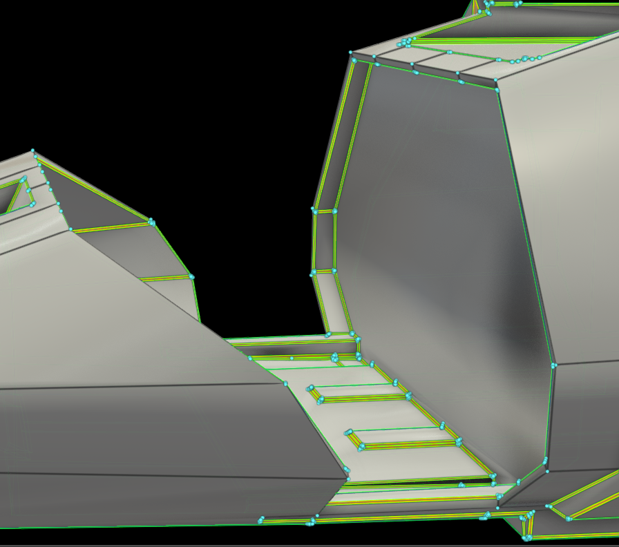

I must be missing something here but I'm not sure why it works sometimes and not others. If I get non-manifold errors I will use a clean sop with manifold-only checked. Often, including in this example, I get the error “Skipping Boundary Edge 2344…” I've tried every option/combination of clean/polydoctor/fuse/facet as well as all of the polybevel settings and still no luck.
If I could just figure out how to make the polybevel work in all cases, it would greatly improve my Houdini modelling game but I get into these situations where it just won't work.
What is going on here in this particular case? The edge I want to apply polybevel to is highlighted in the second image.
Thanks for looking.
UPDATE: I think I solved the problem, please let me know if this is correct. The primitives of my base mesh were non-planar enough to throw off the bevel node, creating bad (degenerate?) faces. I think this was messing up some of my boolean operations as well.

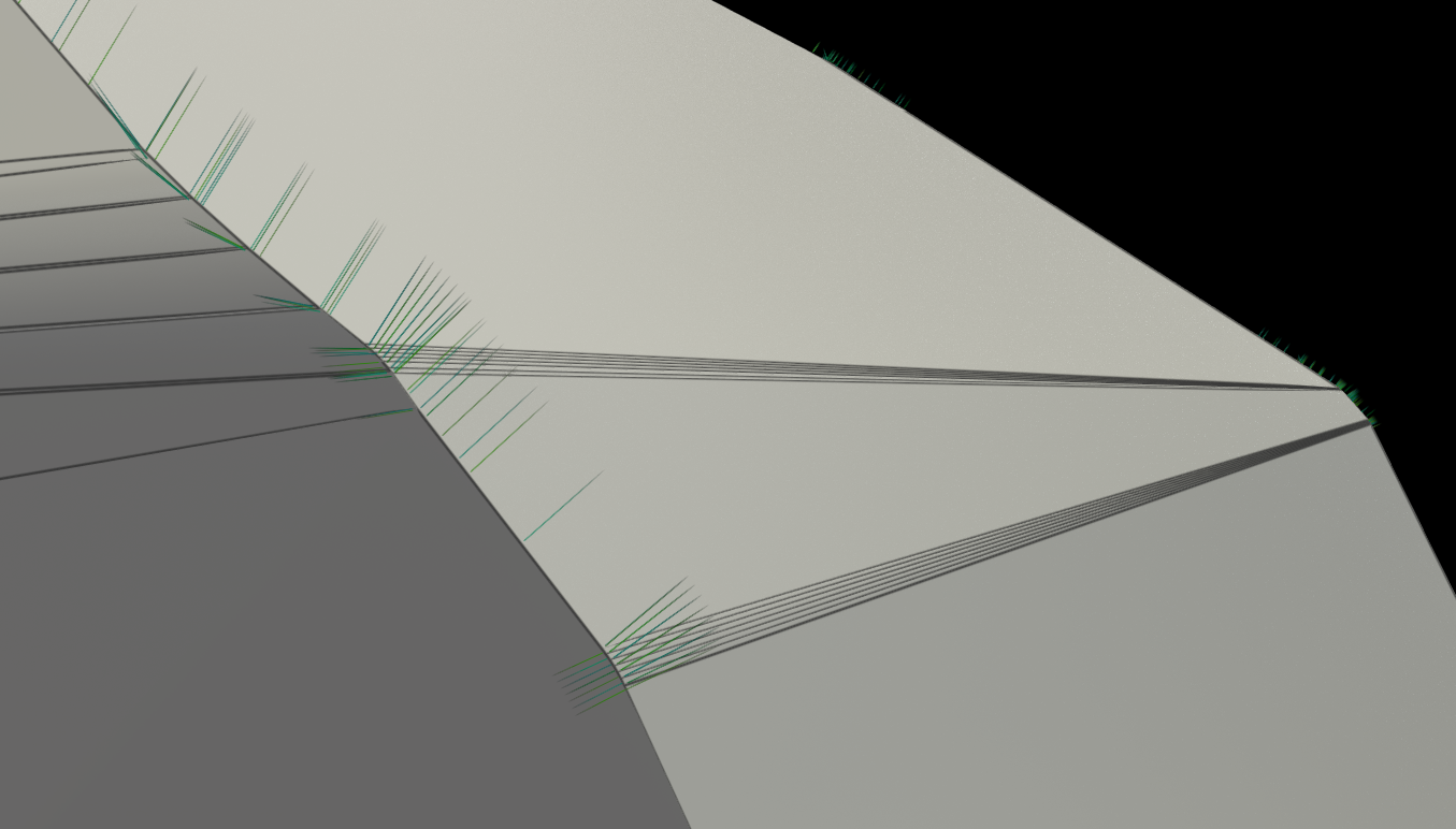

Maybe this is related but I notice this one division from the prior bevel in the boolean that created this edge, is DARKER than the other divisions.
What does that indicate? And why are there two normals there? I have “consolidate points” checked in the clean sop.

I'm sorry, I can't share the hip but it happens so often that I guess I am looking for any input on what causes this error in general. If I do a few booleans, there is a good chance that a bevel won't work somewhere and it's really killing my progress.
There are no caveats in the documentation and very few threads on the issue. I have literally spent 20 hours trying to bevel ONE problematic edge. I've started the model over a few times now trying to avoid the issue, but because I don't know what is causing it, I eventually run into the same issue or some other edge wont bevel. Is it the ngons, is it the verts with more than x number of edges, normals, etc. and then how do I prevent those issues while keeping things procedural?
I really would like to do all of my work inside Houdini but now I feel like I will have to go back to doing my hard surface in other software which sucks because Houdini has so many advantages over a destructive workflow.
I've attached another attempt at the model and it is giving me issues at the same spot. You can see that every edge OTHER than the one I want to bevel, can be beveled… I assume it is because it is the result of a boolean subtraction… but I can't figure out why. (first image has the edge in question highlighted, second image shows how it won't bevel like the rest).

The “Unique Points Along Seams” setting on your boolean subtract may be the issue, it creates disconnected geometry where one surface comes from the original geometry and another surface comes from the cutting box. You can see this effect by appending an explodedview node after your boolean. See if unchecking that option on boolean gives you the result you want.

This is what I mean about the primitves having verts out of co-planar alignment. Polybevel is very sensitive to this, from what I am learning.
I feel like the documentation should read, "The node can handle very complex inputs, so long as the geometry is comprised of primitives containing mostly co-planar vertices.“ … or something to that effect.
This is probably why the polybevel+booleans work really well with ”stock“ geometry like boxes and cylinders. I'll have to be more careful when manipulating primitives from now on.
Is there a ”make primitive planar" function in Houdini? That would be super useful.
In this example you can see the dramatic difference in the bevel resulting from moving one of the points out of planar alignment.
