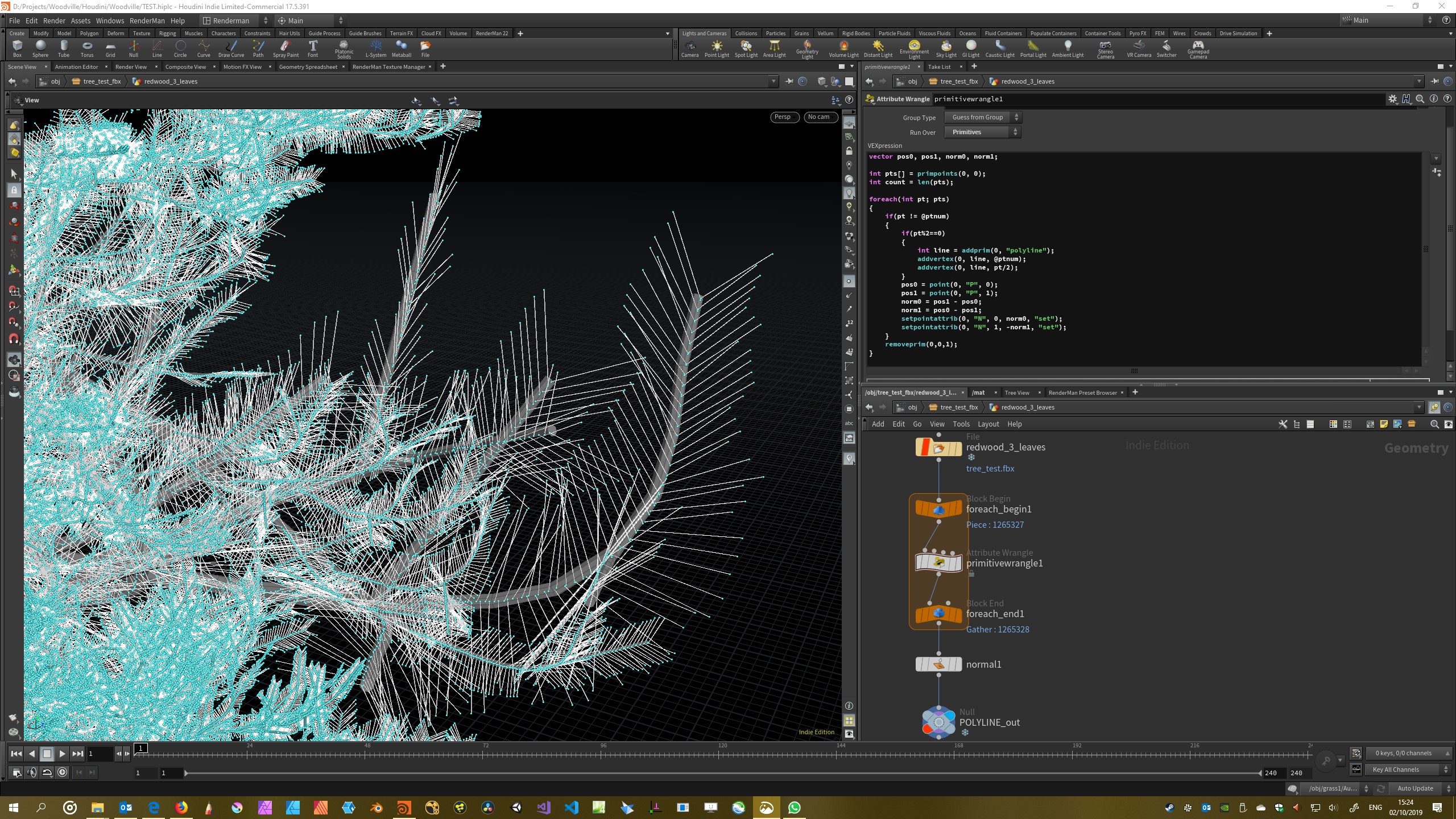

So, I got my fbx tree (coming from Blender) inside Houdini 17.5 and first processed the primitive needles to get single segment polylines instead.
I bet there must be a more optimal way to do that, but given my limited VEX knowledge. I kinda put together this in a wrangle. Do you think I can skip the foreach block? It must be possible to write that directly inside the wrangle…
vector pos0, pos1, norm0, norm1;
int pts[] = primpoints(0, 0);
int count = len(pts);
foreach(int pt; pts)
if(pt != @ptnum)
if(pt%2==0)
int line = addprim(0, "polyline");
addvertex(0, line, @ptnum);
addvertex(0, line, pt/2);
pos0 = point(0, "P", 0);
pos1 = point(0, "P", 1);
norm0 = pos1 - pos0;
norm1 = pos0 - pos1;
setpointattrib(0, "N", 0, norm0, "set");
setpointattrib(0, "N", 1, -norm1, "set");
removeprim(0,0,1);
So that wrangle in the foreach block takes a while to cook… like 9 min.
