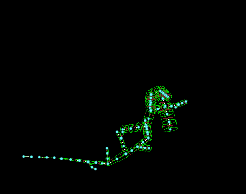

Very cool tool, does exactly what I was looking for!
Sadly though the tree still doesn't seem to want to stand.
Using the L-system tree it works fine, its really rigid and nice. But when I switch over to my custom pine tree it just collapses on itself. :\

Do you have the scale-by-distance trick set up that is being talked about in the video linked above? From your screenshots it doesn't look like it is (or you need to adjust values).

Here is the scene file and tree model I'm using.
I did implement the workflow as mentioned in the webinar.
Maybe I'm doing something wrong?
Thanks.

here you are…I got it working…doesn't mean I know what I'm doing tho.
- Alembic: Unpack instead of the default
- solver: crank up substep and const iterations
vu_DynamicTrees_TREE.hiplc (850.3 KB)

THANK YOU!
Oof those sim times just skyrocketed. Why is this tree so unstable compared to the default Lsystem one?

yes…some please explain from the devs would be nice…I shouldn't have to resort to cranking up the settings…it should just work.

YESSSSSSSS….done it !!! substep back to 1…const back to 100
runs smooth as a baby's bum !!!
Check the new nodes I added.
(can i claim to know what I'm doing now ?…pffft…)
