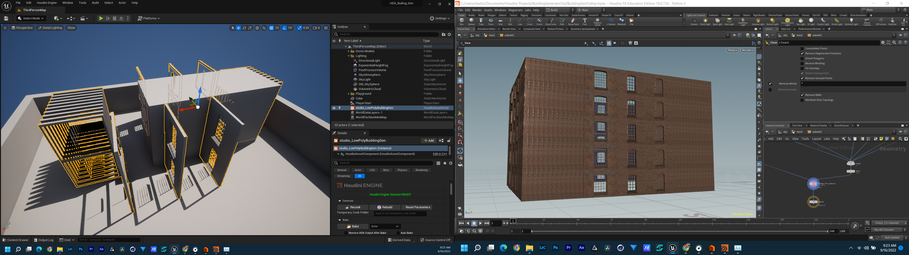

I'm learning so much using the Project Titan Tutorials! Super cool!
BUT, I'm having an issue when I bring my tool into Unreal Engine 5.
For Reference, I'm using Unreal 5.0.3 and Houdini 19.0.726 (education license)
When I attach the tool to a model via the world line input, I get my walls all off by 90 degree. I will try to post a screen shot.
What can I do? In the tutorial, Simon applies a clean to the input, which I did to no real effect. I tried to clean up what was coming out of the merge by deleting the extra FBX parameters.

dward
When I attach the tool to a model via the world line input, I get my walls all off by 90 degree. I will try to post a screen shot.Image Not Found
Same problem.
I have used a normal node and it has partially fixed the issue.
But I have got a lot of error in that module.
It's a bit sad honestly...
