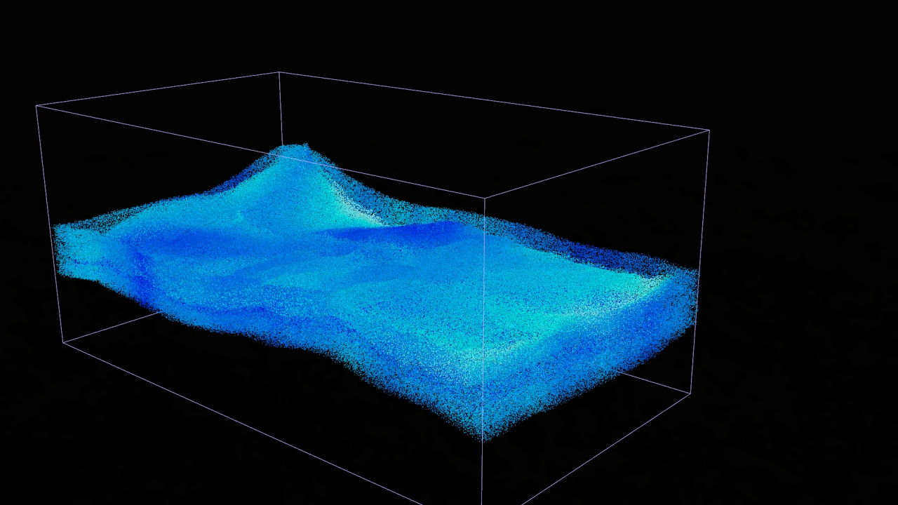

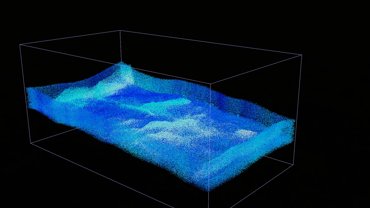

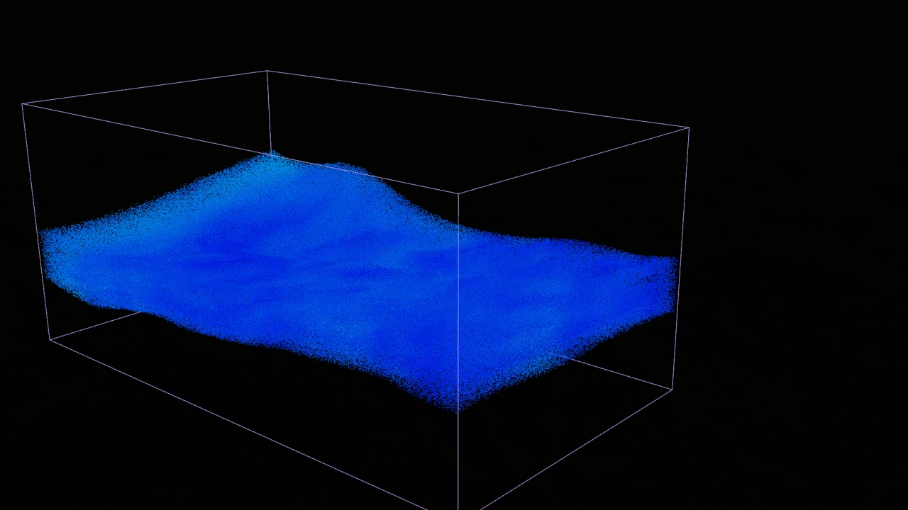

My guided ocean flip sim collapses on itself and I can't figure out what is causing this.
I attached a few frames from my latest flipbook to demonstrate what I mean as well as a screenshot of my volume limit settings.
Any help is much appreciated!

usually when this happens it might be that something is up with the surface field.. just to make sure the Surface Volume parameter has to point to the complete tank surface, not only to a Border surface. T
Or the the boundaries are open. Check the Flip Object. I think the shelf builds a closed tank
