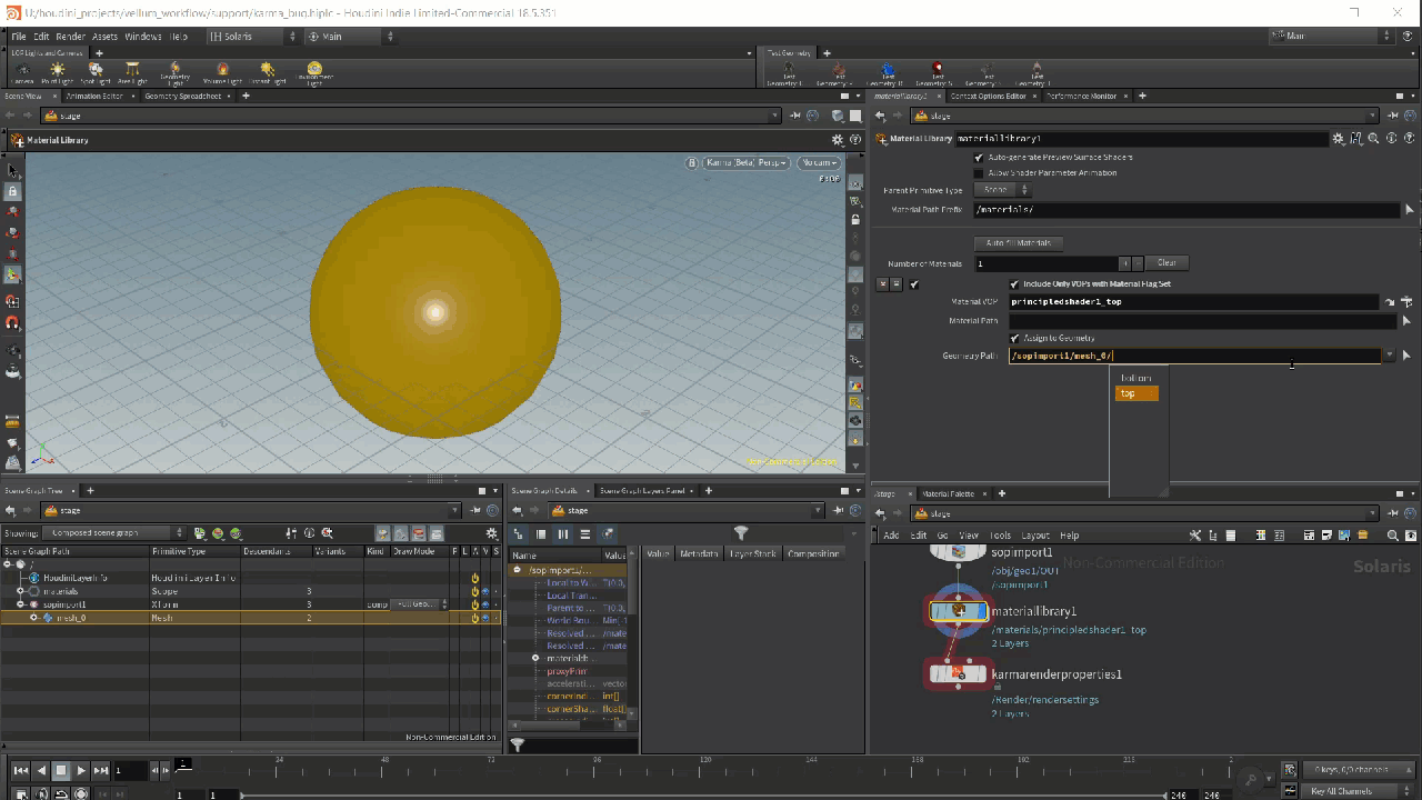

Yep. Same thing happened here. right after I assigned a geometry path to a piece of geometry it switched.
