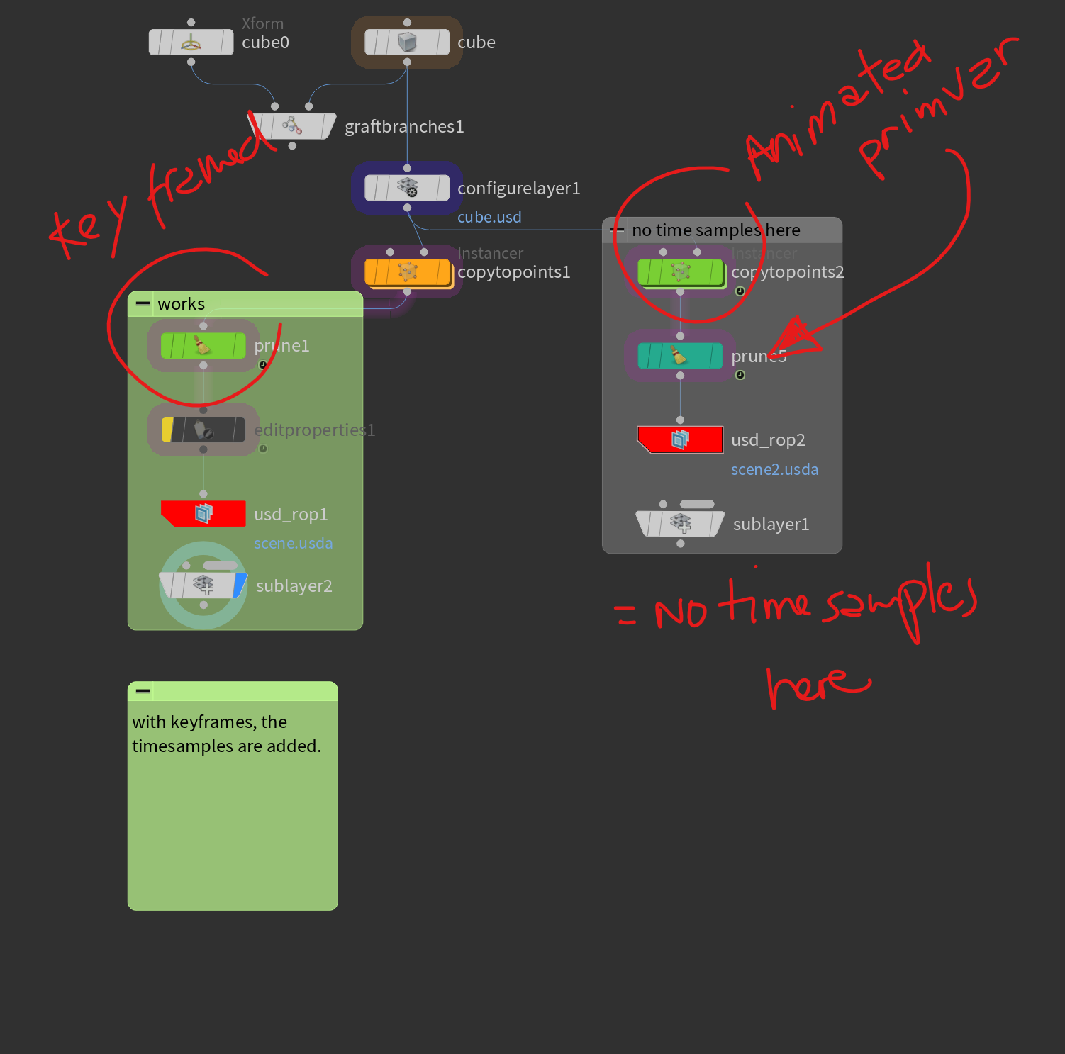

I´ve attached a file in which I want to prune the primitives based on a primvar.
When I use keyframes on the prune LOP, It authors the time samples on the usd file.
When I use VEX with the prune LOP with an animated primvar to prune, the resulting usd file doesn´t have the time samples in the visibility attribute.
I´ve searched the docs and I didn´t find a way to force the creation of time samples in the attribute. I believe LOPs does this automatically, right?
Anyway, are there problems with my approach or It is a bug?
No time samples with VEX in Prune LOP? [BUG?]

I´ve updated the file with some tests with VEX.
I believe there is an odd behavior with the “usd_setvisible” VEX function. It creates the time sample when the visibility is “invisible”, but not for when It should be “inherited”.
I´ve forced the values on the string attrib “visibility” (inherited/invisible) and It works fine.

Regarding `usd_setvisible()` VEX function, as its argument, it currently takes one of two values: 0 (set invisible) or 1 (set visible). Ie, it can't set “inherited” behaviour.
so `usd_setvisible(1)` ends up calling the USD API function `UsdGeomImageable::MakeVisible()`, which does not explicitly set the `visibility` attribute value, most likely because the prim is already visible.
However, this shows that perhaps `usd_setvisible()` VEX function should take another value to set prim visibility to “inherited”. This is now RFE 109097.

Thanks Rafal, but shouldn´t Prune LOP be able to create the time samples when in VEX “mode”?
Because It does create´em when used with keyframes.

shouldn´t Prune LOP be able to create the time samples when in VEX “mode”?It sounds like it should, but I did not look into that yet, so did not comment on it yet.
I´ve tried using the “usd_setactive” function and It doesn´t create time samples too`usd_setactive()` corresponds to `UsdPrim:

Generally speaking LOPs will author time sampled values if the value being specified varies over time. In the simplest case, this means testing if the parameter driving the attribute value is animated. So if you animate the Prune parameter with an expression or keyframes, the Prune LOP will author time samples for the visibility attribute.
However, if the primitive pattern varies from frame to frame, this does not indicate that the visibility attribute should be time varying. Because you aren't varying the value of the attribute for any primitive over time. You are always setting the attribute to “invisible”. You are just setting that fixed “invisible” value on a different set of primitive each frame. So whether you authored this value as a default value or a time sampled value, the resulting behavior of the stage will be unchanged. The attribute would have value of “invisible” for all time.
What I believe you want is to have the prune lop set prims a,b,c invisible on frame 1, then on frame 2 set c,d,e invisible, but explicitly make a and b visible again. But the way you want the Prune LOP to work is to remember that it sent a and b invisible on frame 1, and because they aren't mentioned in the primitive pattern on frame 2, but they were in the primitive pattern on frame 1, set them to be explicitly visible on frame 2. But (except for simulation nodes and some other special exceptions), Houdini nodes don't use history. They are expected to be able to cook frame 2 without ever having cooked frame 1.
So the Houdini way to accomplish what is described above is for the primitive pattern to be a,b,c,d,e for all frames, but then have an expression in the Prune parameter that varies over time, and which is evaluated separately for each primitive. This is not currently the way the Prune LOP behaves, but it probably should be. Just as you can use @prim and @primpath in expressions in an Edit Properties LOP, you should be able to use those same local variables in the Prune LOP.
