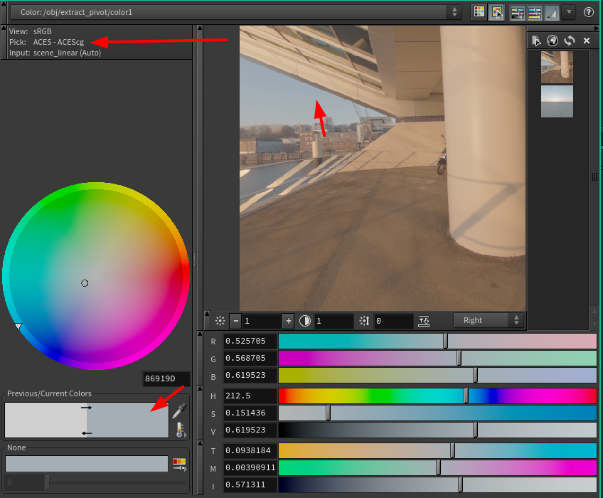

I also met this quetion, and I also find when I turn off "color correction", the image's color will be much closer to the original image, in fact, take a carefully look that is not the right way to handle this problem. In the red box, you can see there are some black dots in here. Have anyone know the real solution? Hope someone can fix it, thx a lot!
upadate: I found that when I don't trun on color correction, the image is aces 1.0 SDR-video look, and off this, it is RAW look.
