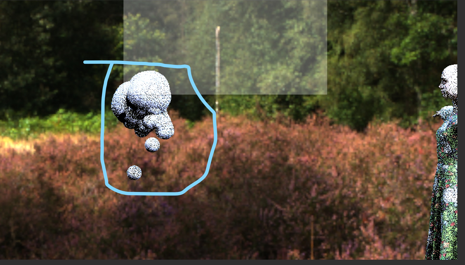

I am getting a strange objects in the viewport while rendering and working with vellum hair. When I Looked closer i noticed that it is the same character i am working on but somehow it mixed up. however it is consuming a lot of the rendering time and work.
Any idea in how to delete and avoid having it in future ?

This duplicated object is still driving me crazy. however, I found out that this object is now showing in the viewport, it only appears during rendering. when I looked into the groups I have in the scene, I see that it is called as “_3d_hidden_primitives”. I do not why it is generated from the first place. I was able to blast it from the scene. so far so good. If anyone out there familiar with “_3d_hidden_primitives” and why it is generated then plz give a feedback.
