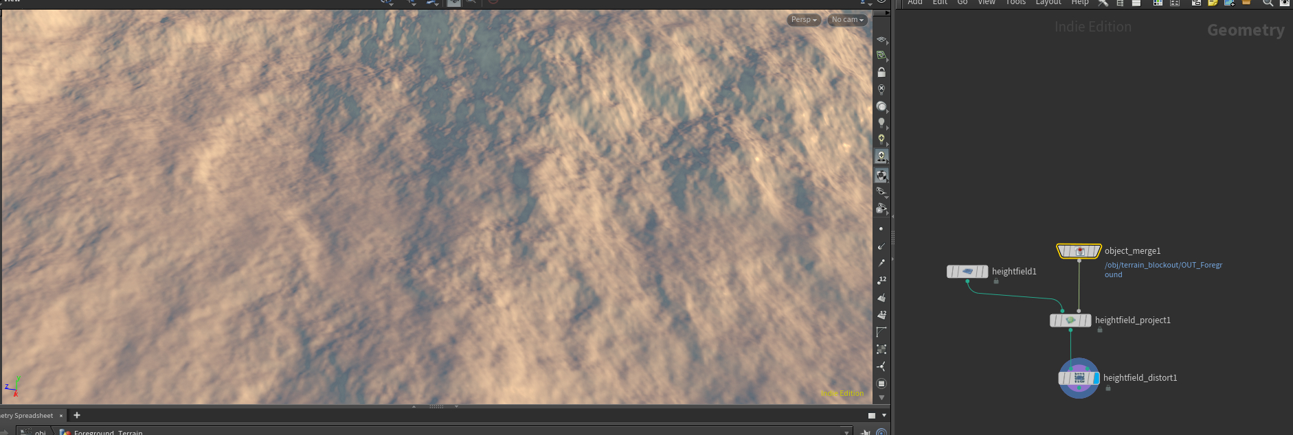

I have been trying to project terrain geometry onto a heightfield.
After the heightfield project node I added a heightfield distort by noise node.
At the heightfield project node level everything seem fine but when I enable the display flag
of the distort node areas of undistorted geometry are visible.
Please see attached screenshots.
Thanks

after some double checking of my nodes I realized that the file I referenced with the object_merge1 node
had a file cache node attached where I forgot to add the .bgeo file extension to the geometry file name.
After adding the .bgeo the referenced file disappeared and now everything is looking the way it should be.
