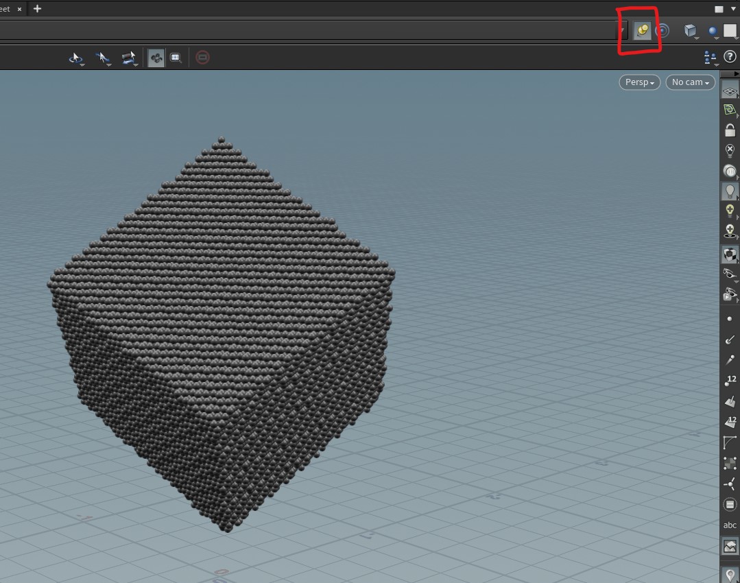

Sprites display as black boxes unless I change the viewport shading mode, in which case they snap back temporarily until I move on to a new node.
This is happening primarily when I create vellum grains.
I'm guessing something is wrong with my spriteshop path? but it's just the default...
Can anyone provide any insight? Thanks in advance!
black box sprites.png (187.2 KB)

I have the same issue in 18.5 would be nice to have a solution for that.

same here, but I fixed it by importing the grain in sops using dopimportfield node and pin the viewport to display imported grain.

This was fixed in 18.5.498.

getting this in 19.5.493!
I can go back up and pin but its super annoying.
