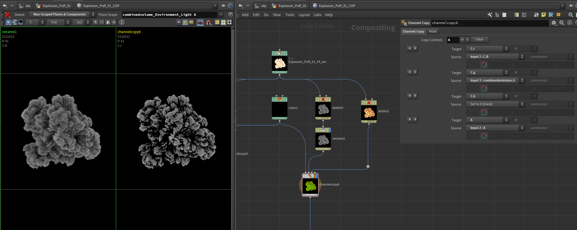

Hope people don't mind if I revive this thread as I have been trying to resolve an issue related to this without any luck on my own.
I have successfully achieved the Aces look on my images thanks to Yades example (thanks a lot!). One issue still remains on my side which I cannot understand why it happens. I am trying to grab some specific layers of the images I rendered and put them all together by using a Channel Copy.
I attached an screenshot of the result so you can see what I am trying to achieve and the issue I am getting. The image on the left is the actual Smoke I want to export in the red channel of the texture. The image on the right is what I currently see on the red channel of the texture I am exporting. I renamed the image to C rather than the original name (environment light), but the results are always the same.
I am not sure of what the issue is. The emisssion channel (C.g) looks completely fine and exactly the same as the original input. If I disable OpenColorIO, the smoke texture looks alright but then the rest of the channels look wrong. Does anyone have any ideas that could help?
