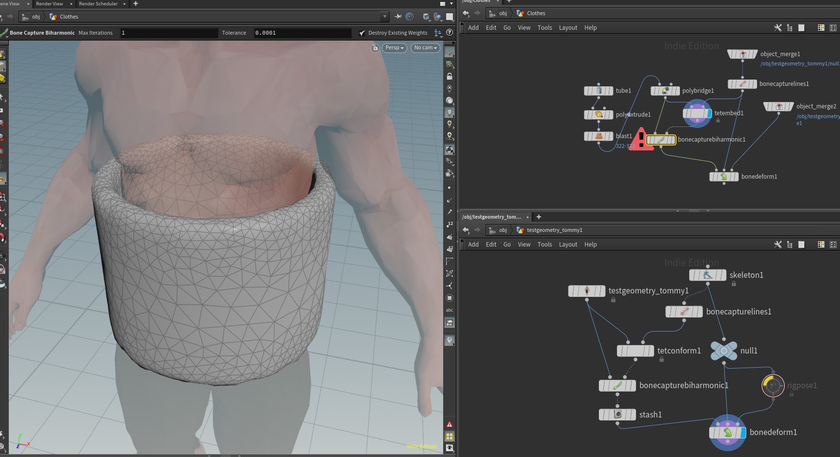

Struggling to find a way to do this.
If I have baggy clothes then point deform doesnt work very well. If I have cloth that is thick (double sided) I cannot get tet embed/ bone capturebiharmonic to work, which is the only way I know how to rig it.
I am looking for a node / way to either manually weight paint the cloth or a node that can capture double sided geometry.
Here is an example:
I just want to capture this tube to Tommys waist. I don't want to use point deform.
The only way I know how to capture cloth is this:
As you see the capturing errors out, presumably because the tets dont intersect with the bones.
How would I rig this up?
Thanks.
Edited by SB26 - June 28, 2021 04:45:26

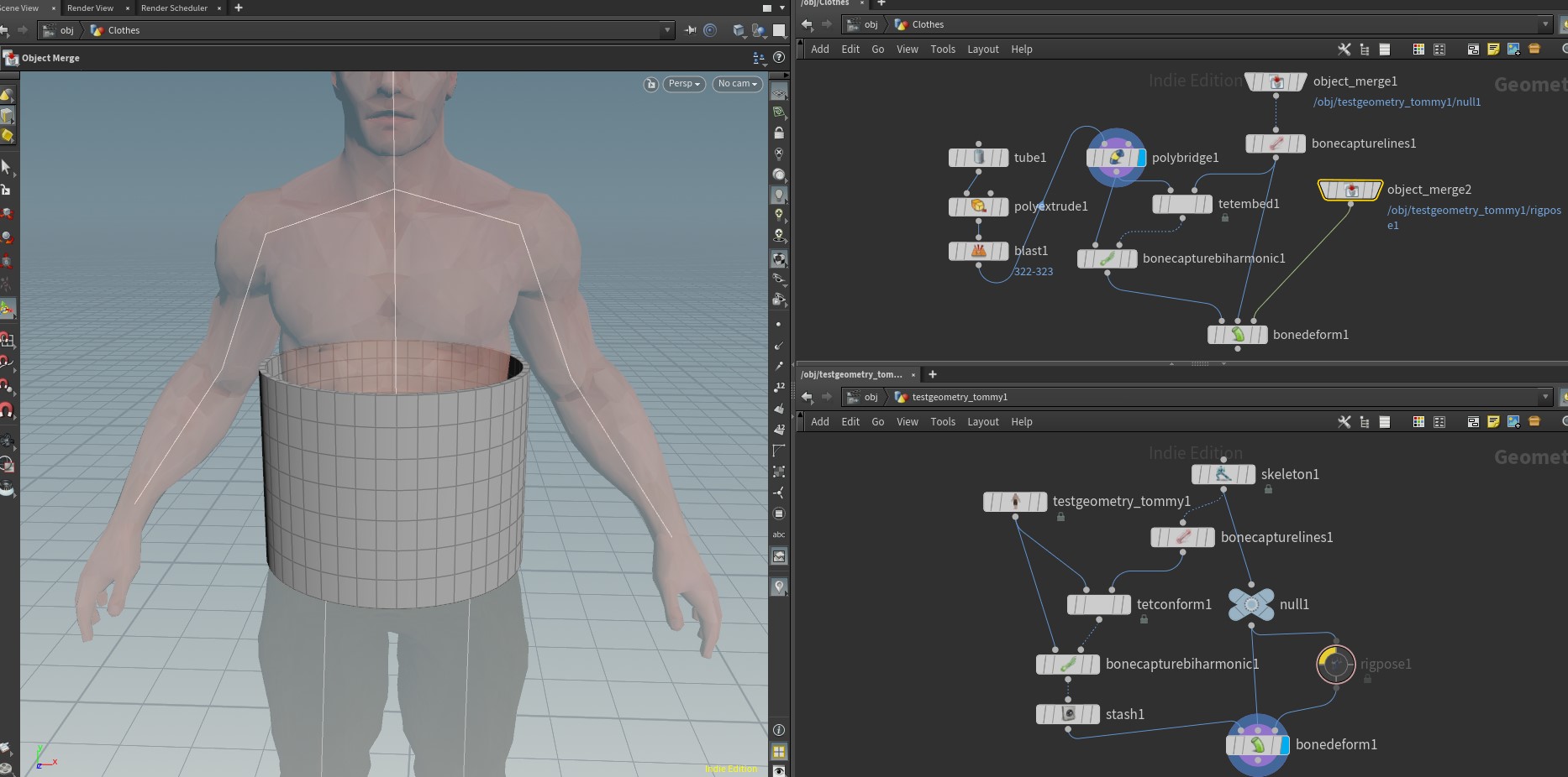

Maybe I am not being clear with what I am asking.
If I have cloth I want to capture to a (kinefx) rig, then how would I do that without using tet embed/conform, nor point deform?
