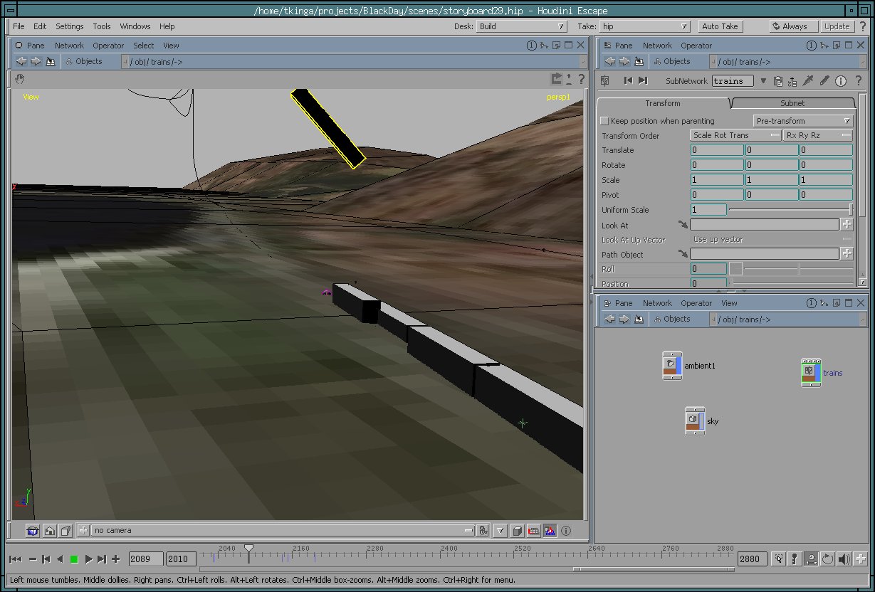

Hi..
I appear to have a strange display issue, where by my objects seem to be having
depth sorting or display issues. The problem is really bad as it flickers as I work
around the scene while orbiting. Things such as disappearing objects and rear
objects appearing in front of nearer objects.
It's causing me great problems while I try to animate.
I have added to example screen grabs.
Anyone else having such problems.
System:
OS: Linux 64bit
Kernel: 2.6.21
CPU: Dual AMD Opteron
video card: Nvidia Quadro FX 1400
Video driver: Nvidia 1.0.9755-5
Thanks
Tom
Almost forgot to mention what version I was using..
houdini-8.2.91-linux_x86_64_deb_4.0
Thanks
Tom

You might try going into your view port display options and increasing the Near Clipping Plane distance to something like 1 or 10. If your scene is large, unit wise, this might help. It has for me.

Hey..
grahamt you are amazing..
Thanks for the solution, works like a charm.
Have a great one..
And thanks again, you saved me..
Regards
Tom
