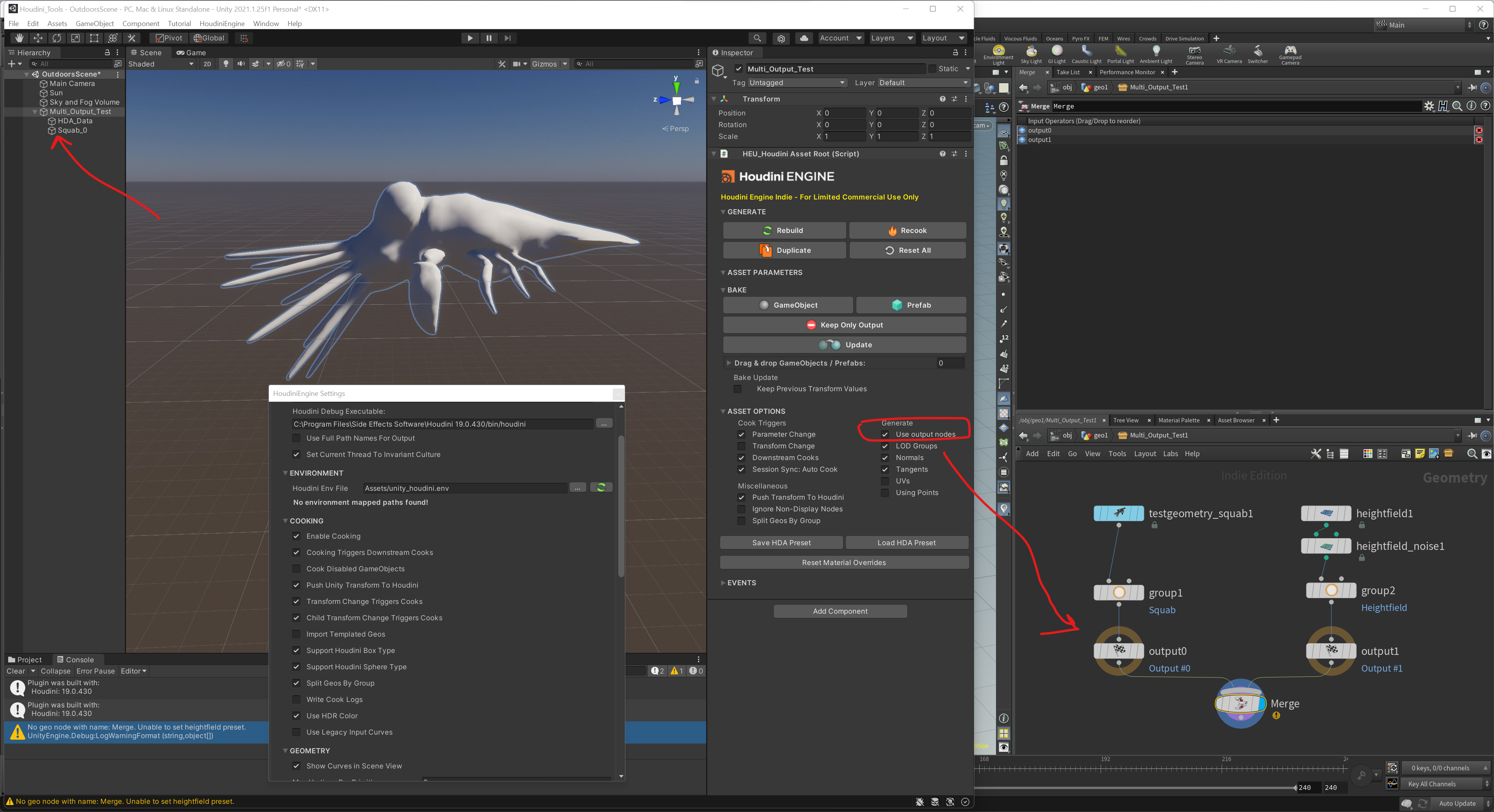

Hello,
I have problem with having desired number of outputs in Unity with hdalc files. When I am using use output nodes but it always adds one extra object.
Can anyone tell me what I am doing wrong?
Thank you in advance.

Ive grabbed latest and wiped my old plugins folder for the new package in 19.0.430 , unfortunately im still seeing a problem with the multioutput
The image below shows that it still is not outputting the second outputs, am I doing something wrong?
The second image shows that by setting split by groups I get both results out of my hda, although its odd because it needs to be set in the plugin settings , the "split geo by groups" toggle in the hda itself does not do anything
