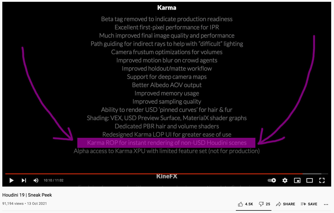

Looking at the sneak peak video, I'm curious about this Karma ROP. Let's hope and see.
