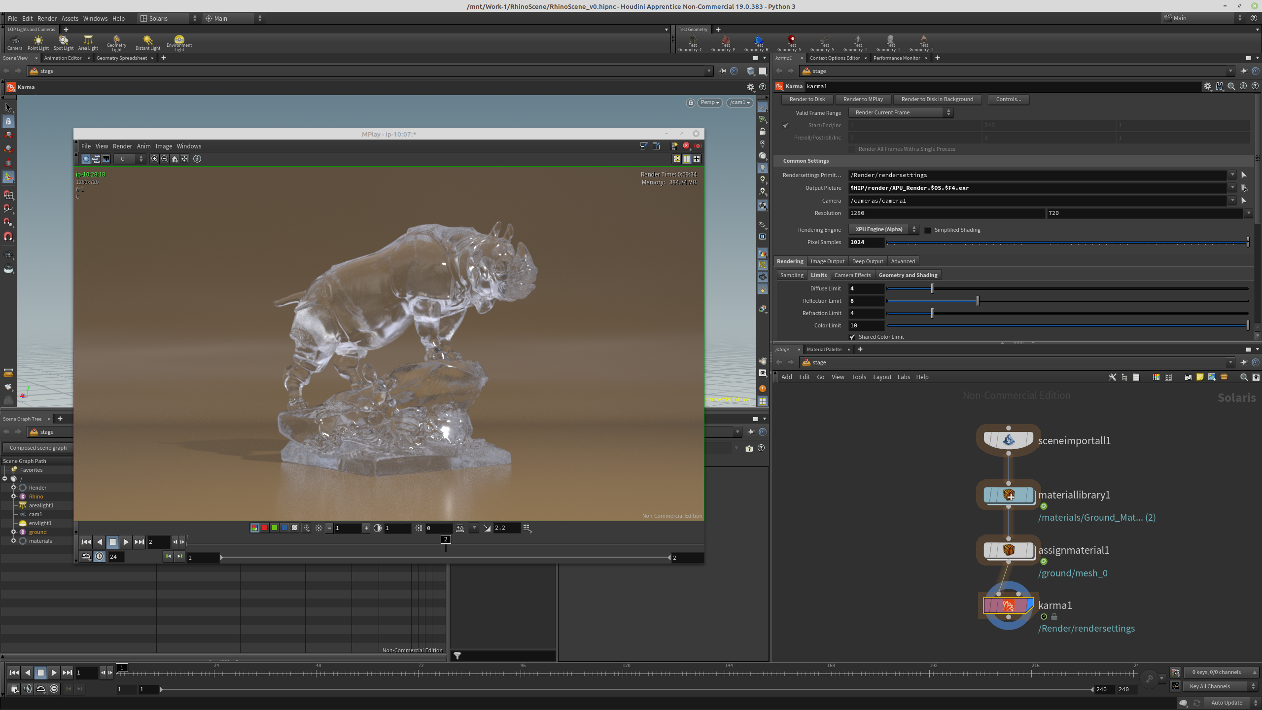

I installed Linux Mint 20 on my AMD 8 cores with a GTX 1650 using Nvidia drivers 470.74, and there is a dramatic incrase in speed on CPU, and a noticeable increase on XPU compared to Windows 10 Workstation.
CPU:
Linux 20:54
Windows 55:07
XPU:
Linux 09:34
Windows 10:49
Screenshot from 2021-11-05 10-27-59.png (1.7 MB)

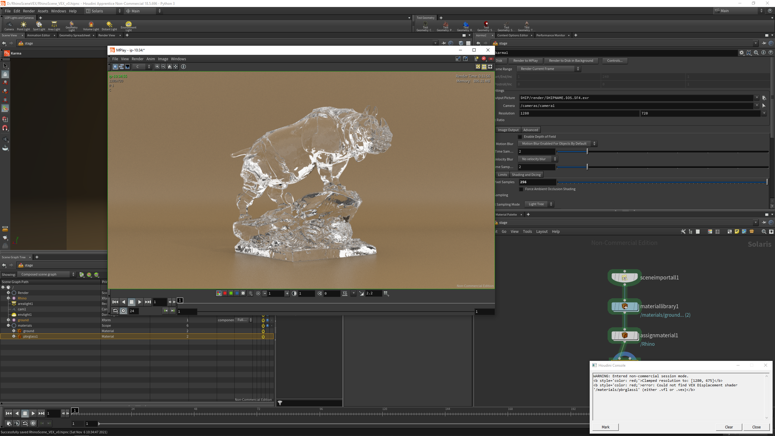

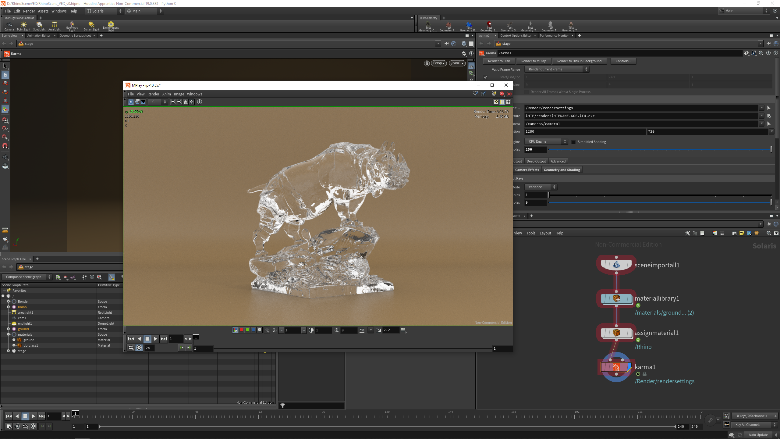

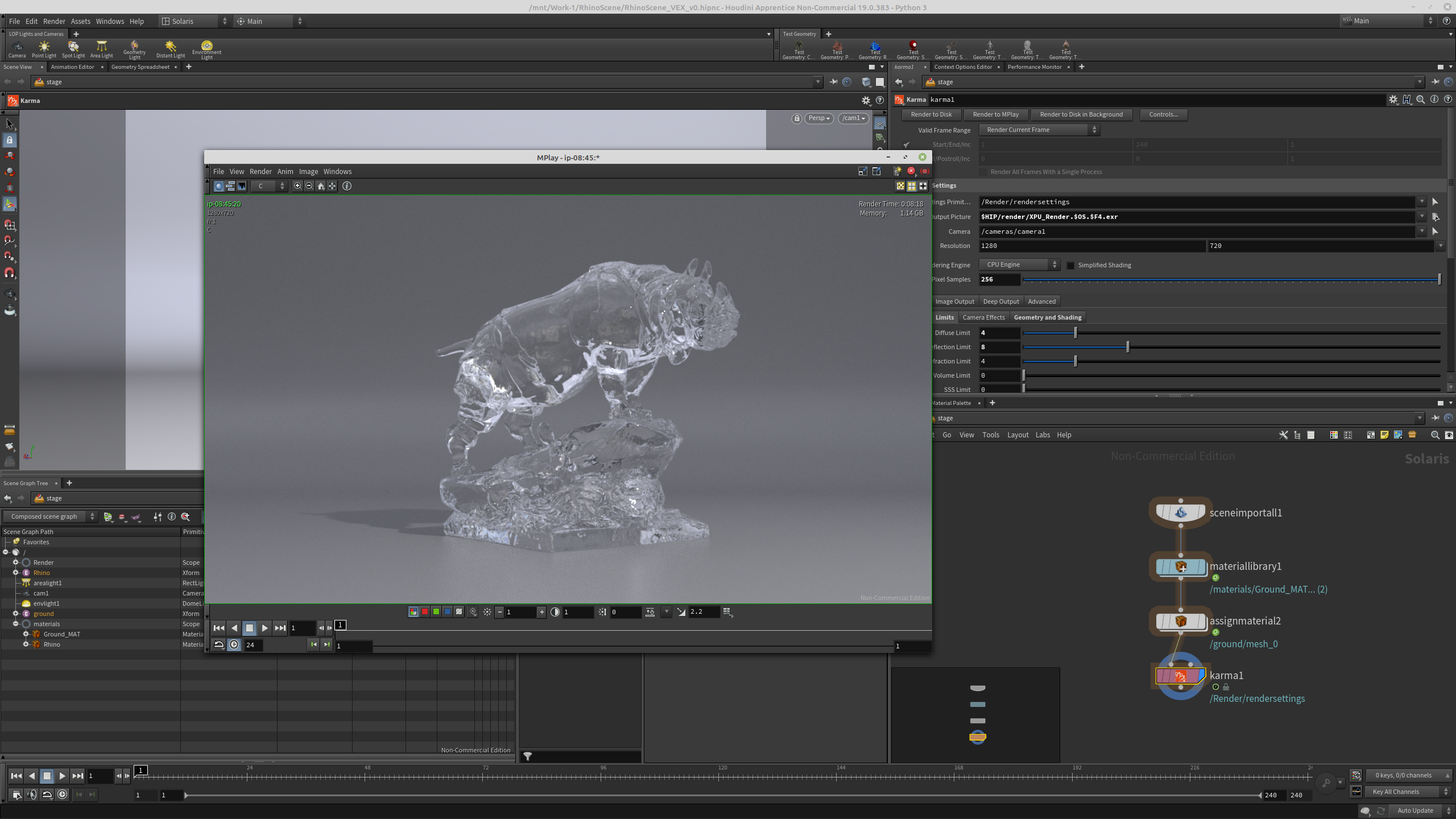

This bothers me, so I modified the scene to use Vex shaders instead of MatrerialX shaders and rendered it in H19 in linux, I lowered the sample count to 256 to make it faster, since it's a CPU only test, I will re install Windows 10 Workstation and render the scene in both H18 and H19, to see if this is a Windows bug, or if indeed there is a huge render difference under Linux!
Linux H19 CPU render time: 8:18
Windows H18 CPU render time: 11:56
Windows H19 CPU render time: 26:49
I attached the VEX scene
Edited by GCharb - Nov. 6, 2021 11:25:00
RhinoSceneVEX.zip (8.7 MB)
Screenshot from 2021-11-06 08-53-46.png (1.6 MB)
Screenshot from 2021-11-06 10 48-33.png (1.6 MB)
Screenshot from 2021-11-06 11-23-44.png (1.7 MB)
