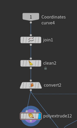

I have a same problem.
Unity 2021.1.28f
Houdini 19.0.383
I've struggled to handle this problem so much.
PolyExtrude node acts like it receives an open curve even if "Closed" parameter is checked in Unity.
Is this proper specification or glitch?
This is my workaround.
Edited by aoi36e - Nov. 30, 2021 23:56:02
Unity 2021.1.28f
Houdini 19.0.383
Thx for workaround it will work for now, but i hope they will fix it so my old graph will bo compatible.
