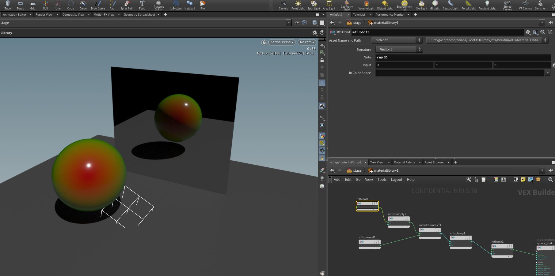

jsmack
I found using the geompropvalue to get 'I' also works, and works correctly in reflections.
'I' is not really a property of the geometry, so I don't think it would really be valid to have it come through via the geompropvalue. (again I'll chat to others at SideFX to see if XPU should support it)
IMO a better way to get the incoming ray direction is via the MtlxDot ray-import stuff (that works in both KarmaCPU and KarmaXPU).
https://www.sidefx.com/docs/houdini/solaris/karma_xpu.html#summary [www.sidefx.com]
So to do what you're asking, I would suggest...
- have a MtlxNormal node (set space to "world")
- have a MtlxDot node (put
ray:D
as the note), and multiply by -1, which will produce the equivalent of "I"See attached example + screenshot
