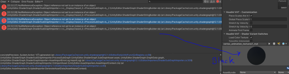

Whenever I add the VAT 3.0 package to Unity it ends up with an error and shaders don't work.
Thanks

I solve it only with installing Unity 2021.2.0b9.3. It was eventually that any Unity version later than 2021.2.0b9.3 has this bug.
