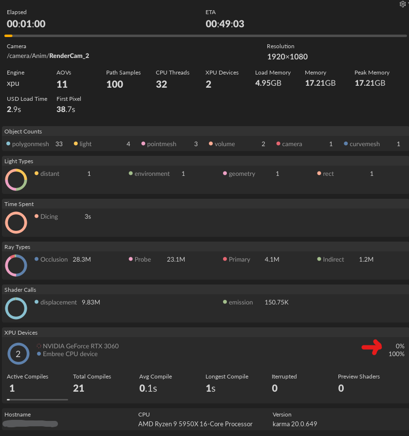

Any news on this?
With drivers below 546.33 i get the exit code -1073741819 when rendering sequences and with 546.33 and above i don't have gpu support. No matter what is set in the houdini.env
Im on latest daily build 20.0.649 and a rtx 3060

97 posts
Joined: Nov. 2017
hmm strange, according to the nvidia control panel I'm on 546.33 and GPU isnt working... (Im on Windows)
If you confirm that 546.33 is working on your end, I need to investigate
Otherwise i try to create a repro scene

514 posts
Joined: May 2019
SiRpRoHxO
I've tried with 20.0.625 and 546.33, and Karma XPU is working fine for me.
And are you saying with a more modern driver you get no GPU support at all? What happens in the viewport? Is it just sequence rendering that is broken for you? Or is it XPU in general?
thanks
97 posts
Joined: Nov. 2017
I now did a complete driver removal with DDU and it seems that did the trick.
Updated to latest Nvidia driver and gpu support works again.
so maybe some old driver remains that got in each others way...
